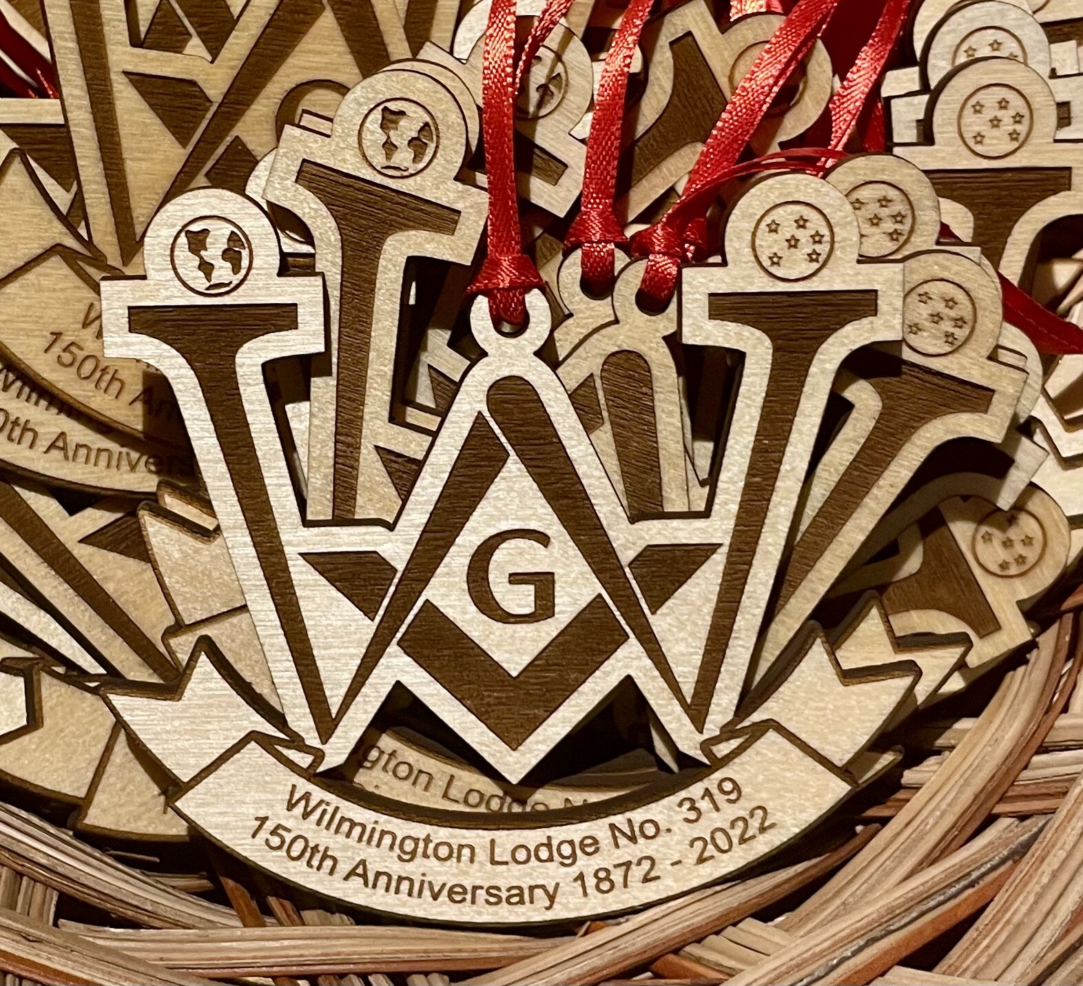

My Masonic Lodge celebrated it’s 150th anniversary last night. Made some commemorative ornaments to hand out.
Laser engraved and cut from 3mm Baltic birch ply that was prefinshed with a gloss lacquer.

Ok, here’s the break down
Lacquer
  • I use lacquer for a lot of these types of things mainly because it’s quick drying. Also using brush on lacquer allows me to build up a solid coat quick.
  • I use other finishes sometimes, but for things like this it’s about the drying speed and coat thickness. A thick high gloss surface adds good contrast with the engraved area for a light colored would like birch. I typically use polyurethane on things like darker wood because it pops the grain better than lacquer, but does have much longer drying/set times. Also sometimes I don’t want or need a thick high gloss finish.
Prefinishing
  • I typically prefinish for several reasons. First is because I use a spray to darken the engravings. Plywood by it self doesn’t engrave darkly, so poor contrast. Prefinishing seals the surface to help prevent edge bleed under the masking.
  • Because I mask the wood before engraving, for laser engraving residue and spray darkening, sealing the wood prevents the grain from raising up when I remove the masking. So I don’t have to re-sand.
  • Lastly, putting a finish over the engraved area can add reflection in the engraved area which reduces contrast.
