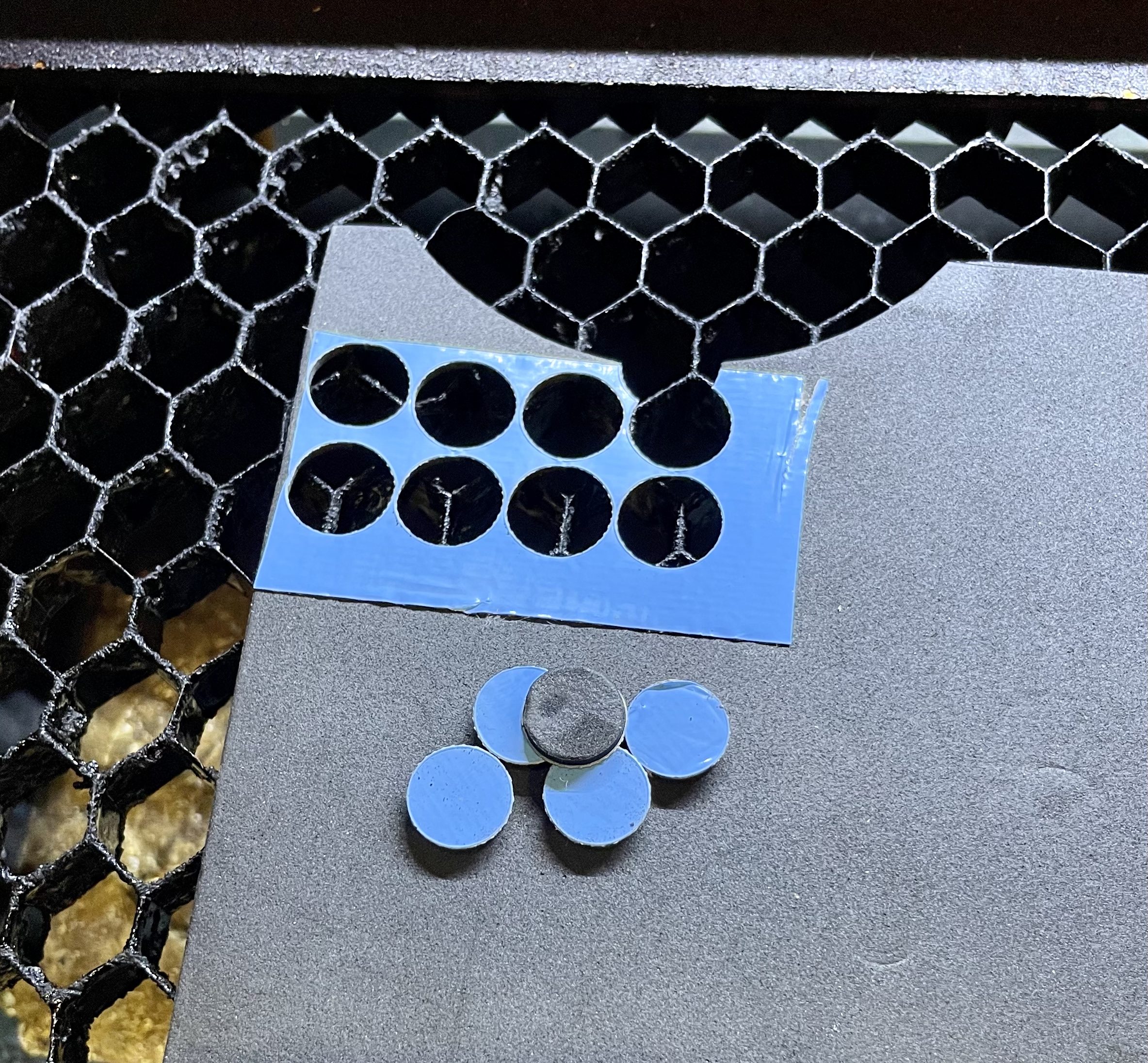

I needed some thin padded feet for something. I took some 2mm craft foam sheet I had and applied some double sided tape to the foam. Laser cut out some 1/2” circles and had myself some instant self-adhesive padded feet. :grinning:
Very professional! I feel like I may have cut out the foam, then cut out the adhesive, then tried to line them up. Doh!
