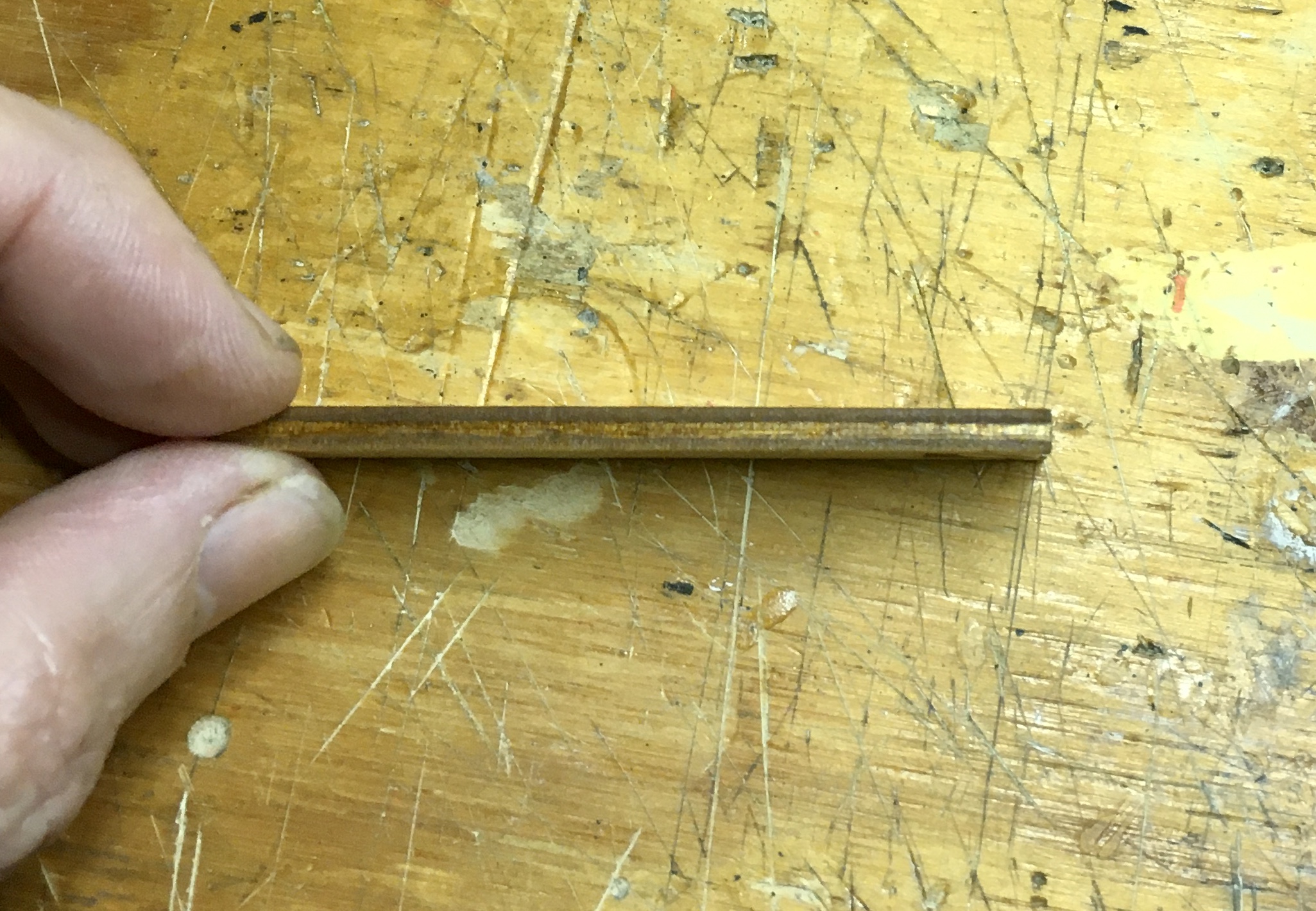

When double stacking nuts you typically place a wrench on the bottom nut and one on the top nut to tighten them against each other. In my case the bottom nut was flush against the washer inside the cabinet and it was a tight space. The nuts were only 1/8" thick and none of the appropriate sized crescent wrenches I had were thin enough to just grab the bottom nut. The tight space also meant that I couldn’t try and grab it with the tip of some needle nose pliers.

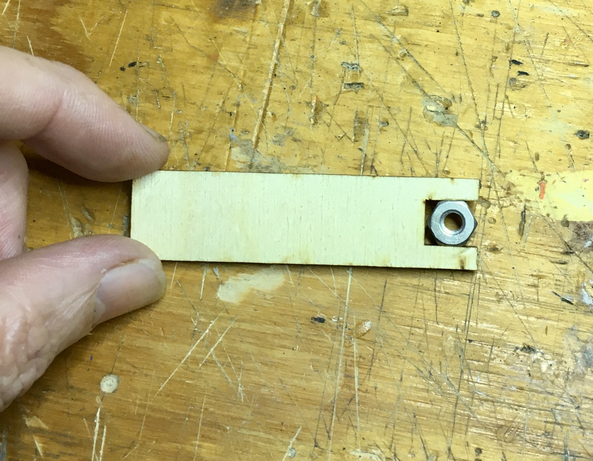

Then I realized that I had 1/8" plywood and could just quickly laser cut an opened ended wrench. There wasn’t going to be a super amount of torque so the plywood would be fine. Worked great.

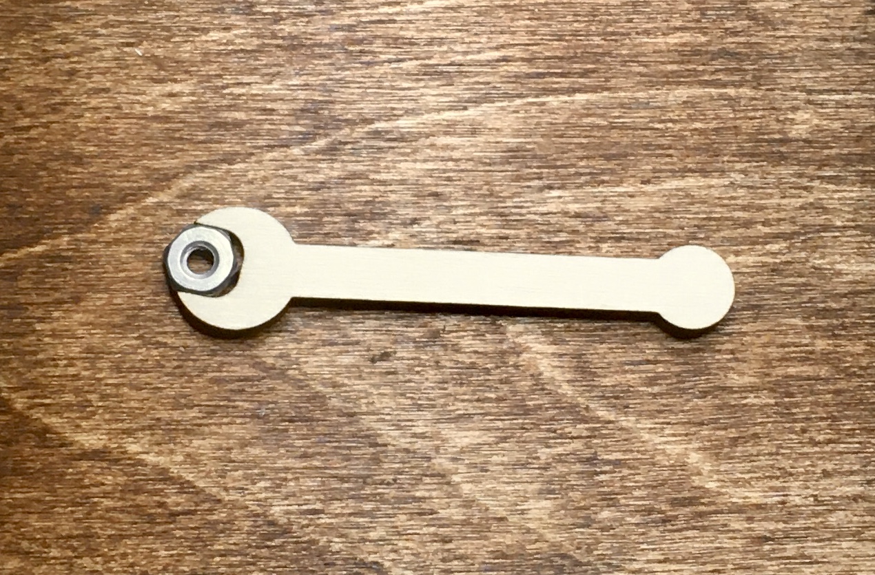

Ok, last night I was closing out the hatch dog design file and I decided I could not leave it alone with that quick and dirty “wrench”.
Cut a more traditional crescent wrench design with a curved nut slot bottom to distribute the strain over a wider area.
Also cut a box wrench which, when press fit onto the nut, makes a great lever knob for any nuts that need to be tighten and loosen frequently.
