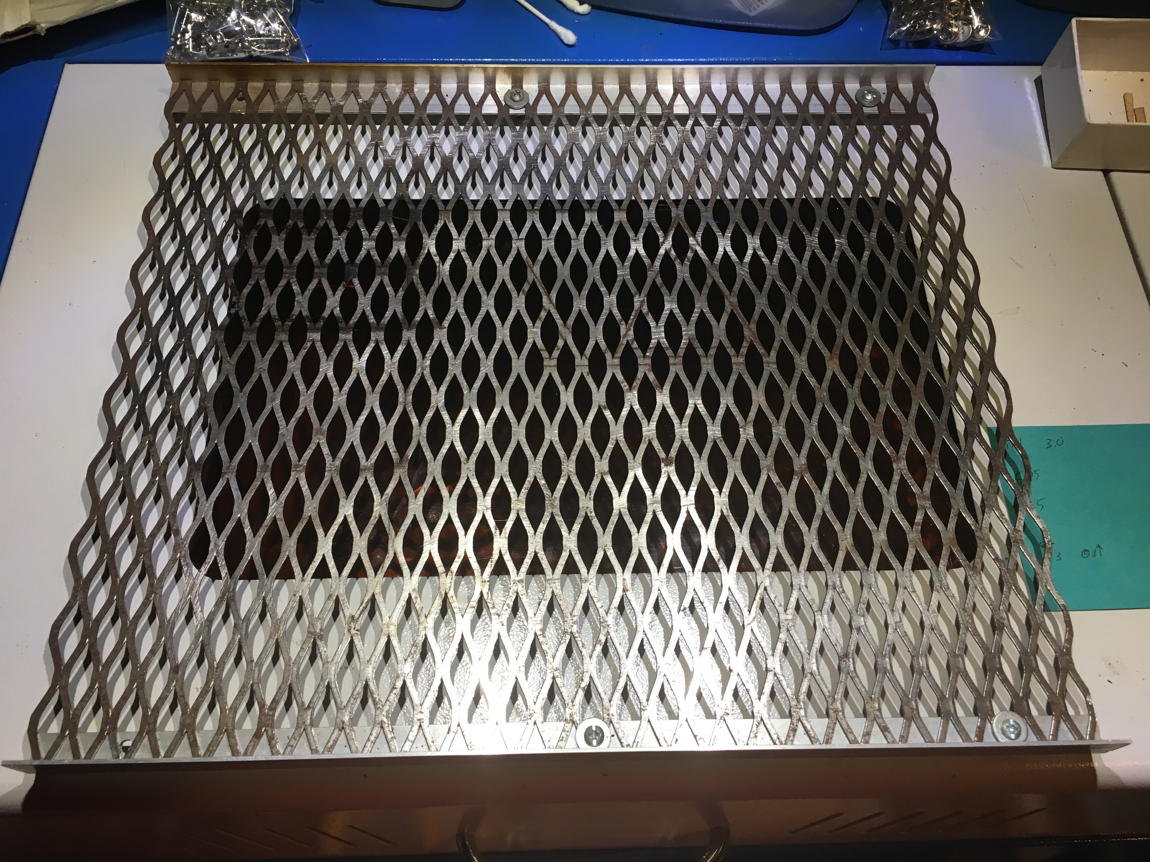

@Joel_Brondos In practice as long as you have a way to reposition the jig (i.e. origin jig) then you are fine. You can always check the alignment by jogging the laser head to the corners and doing a test fire to make sure the corners are were they should be relative to the template file. I’ve done this numerous times. The thing you really need to watch out for is making sure the template doesn’t move around after you get it positioned. When I’m doing engraving work like this I use an expanded steel mesh bed that let’s me use magnets to lock everything in place.

This is what I use as a bed for jig engraving. Expanded steel mesh with aluminum angle stock supports. Only used two end supports since the mesh is only really flexible along the long axis of the holes. I use the honeycomb for everything else because the expanded mesh causes lots of back burn and builds up lots of wood cutting residue that can be problematic if you care about the back of the piece.
