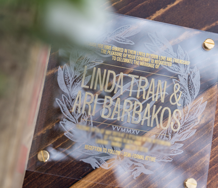

Laser engraved wedding invitations - painstakingly hand painted. Was a huge labour of love but our guests were impressed.
Those are very nice & I can imagine the painting would have been painstaking indeed.
