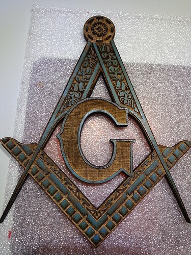

When engraving wood, especially plywood, it can be hard to get a dark burn in the wood. So you end up with poor contrast of the engraved area with the surrounding wood.
For years I’ve been using Minwax Mission Oak satin polyshades spray to darken my engravings while they were still masked. It’s basically polyurethane mixed with a stain.
Works great with low bleed.

The problem with using a brush on stain would most likely be with bleeding into the lasered edge grain under the masking. I’ve had this problem with using multiple colored stains on one project. I mitigated some of the issue by first applying a clear sealer spray to try and seal the laser exposed edge, it can be hard to get everything sealed well though. Using a pre-stain is definitely a thought though.

Usually it’s the very top edge of the wood that’s the problem. Typically bleed isn’t an issue if the wood is sealed first with a finish before engraving. I usually prefer to engrave wood that’s been finished, but sometimes I can’t do that because I’m going to do selective area painting or staining after lasering so I need bare wood. But still want the dark engraved area. That’s’ why I will typically try sealing the engraved area with a flat clear finish before trying to darken the engraving. Just have to be careful not apply the clear sealer it too heavy or the edge of the masking can release a bit
The polyshade product is very low wick so it was easy to work with. I’m just concerned about using a lower viscosity product which may wick easier.
