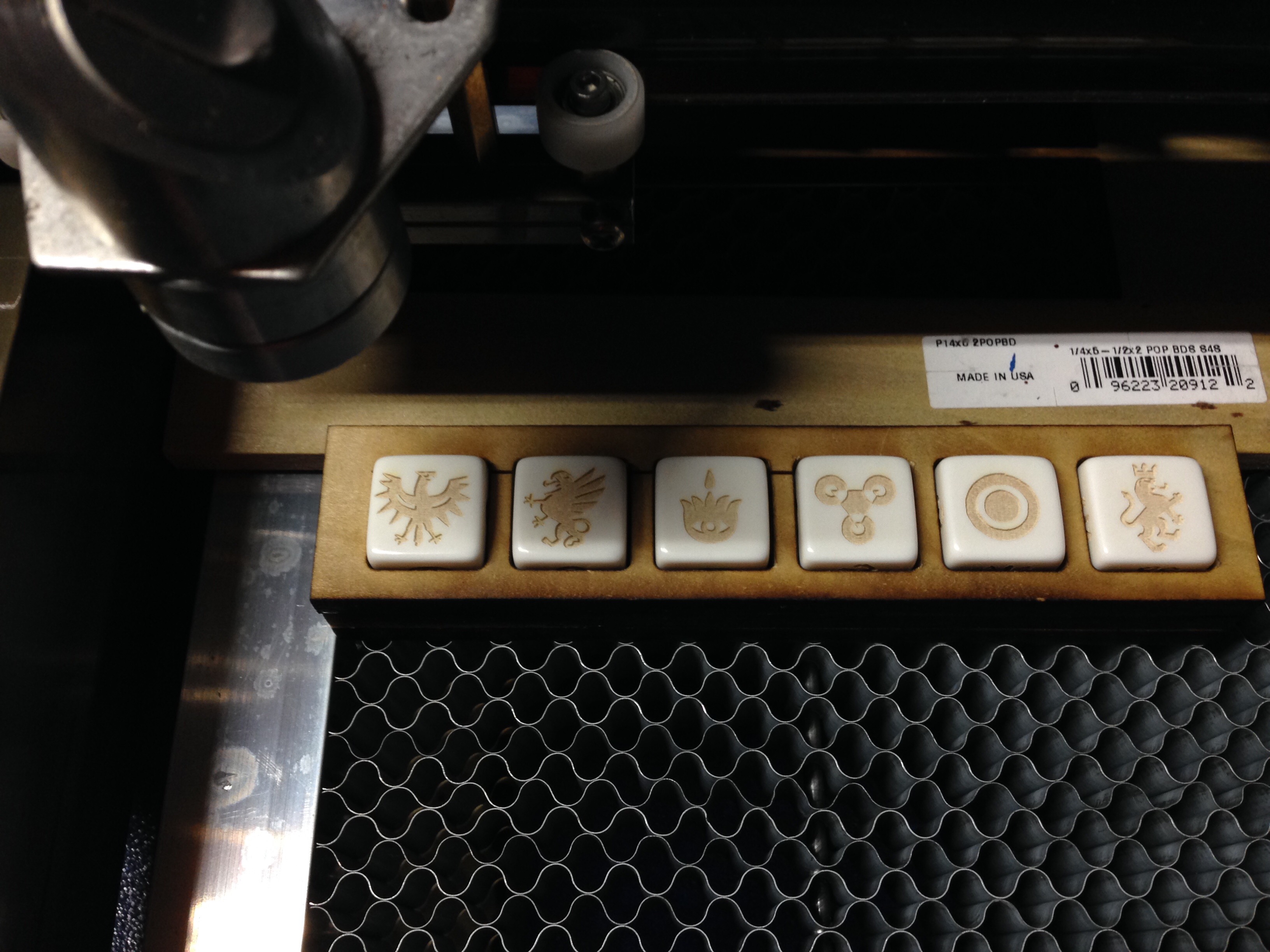

Laser etched dice! I cut a little holder to help with alignment.
Laser etched dice! I cut a little holder to help with alignment. Since there are 6 sides, I can set the job to repeat 6 times, before continuing each job, I can rotate each die and move it to the next slot. So after 6 passes, I have 6 complete custom dice!
Settings: 10mA, 320mm/s.

Also, if I want to make less than 6 dice, I have little stone inserts to take the hit in the unused slots. Still takes 6 passes.
Looks very nice. I’d set it up so there are 6 of each side in the design file and send the file - does the whole lot of them. Then rotate the dice and do the next side on all of them. No repeats, just 6 sends. I’d have all 6 sides as layers in Corel and then send 1 layer at a time.
I really like these and will probably do custom dice for a Cataan board I’m making.
Well done on the alignment. Dice look great.
If you wish to do less than 6 dice, you will be wasting CO2 from the tube every time you fire at the stone inserts. You are better off creating more copies of your 6 icons that omit the number of dice you are not wanting to do.

So you would have 6 layers, first layer with icons A B C D active & icons E F hidden. Each successive layer will deactivate different icons, as you will be moving the blank dice (1, 2, 3 & 4) one to the right every time & rotating to get the next side done.
You would still be doing 6 passes, but wasting less of your tube’s CO2. Hope that makes sense.
edit: grr my spaces I put in the diagram were not displaying correctly to align the numbers where I wanted so I added . instead of spaces. Ignore them.
Good suggestions!
I was doing the “repeat 6 times” for convenience, but queuing up 6 tasks with different layers active, while a few extra steps, would be more efficient. Another subtle difference is that way all the dice would have the same faces on the same sides.
