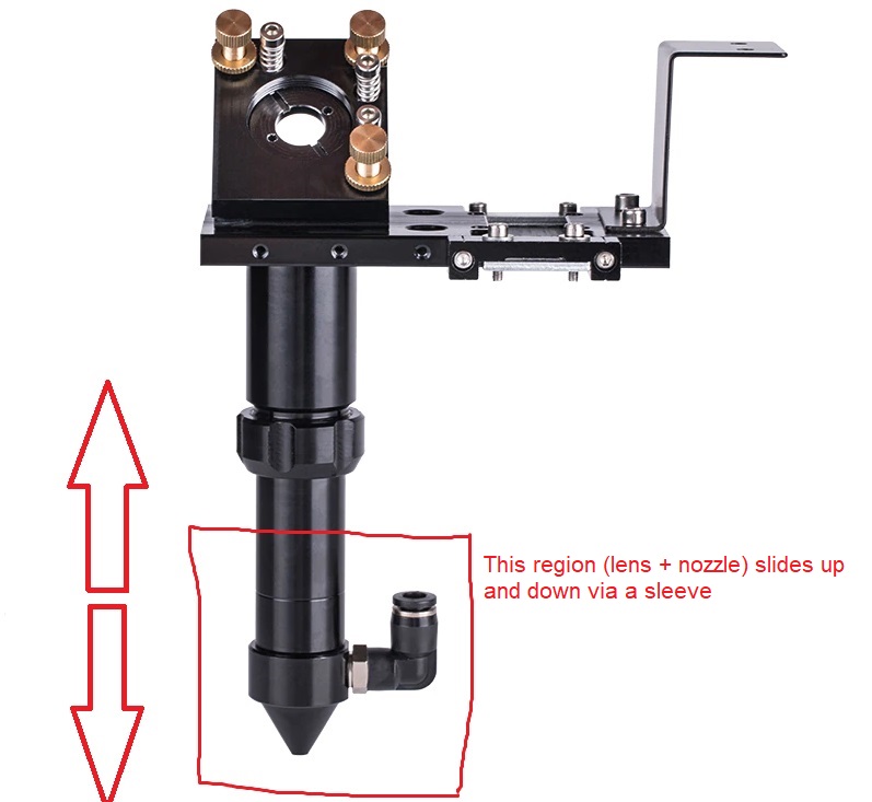

However, I was thinking along the lines of moving just the nozzle with the lens, since the focal length is determined from the lens to the surface of the material to be cut. Something like this:
Perhaps the issue would be fitting the linear motion mechanisms to the limited space at the laser head… Damn this makes me so curious as to how the laser cutter in my school’s maker lab did it :thinking:
Will keep looking around and update this thread with anything I learn.
If you look around there are optimizations to lighten the “moving” head as much as possible and adding that type of mechanism you mention would add both a motor and some linear motion elements to not only the laser head but also to the nozzle hanging off the laser head.
It can be done it just means you’ll be limiting your max scanning speed.
