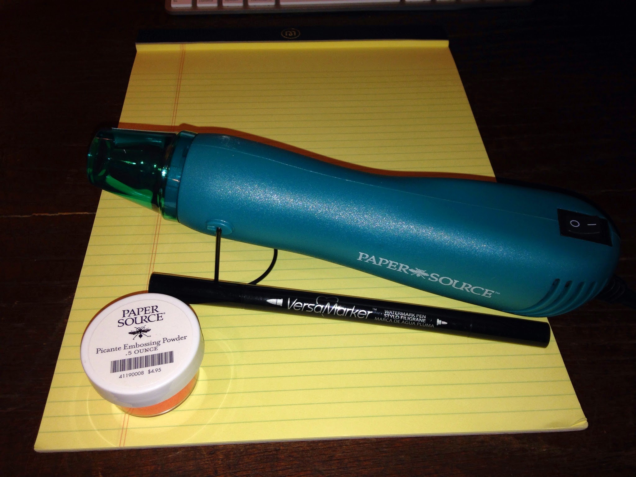

I wanted to see whether embossing powder would adhere to itself to create a 3D form. I accomplished this by applying a layer of glue over a previously embossed layer. The results are encouraging.

How are you heating the material?
For the experiment, I heated it with the heat gun shown in the first photo. But in practice, there would be a heating roller or a corona wire. Both of which rely on resistive heating. The heat gun blows hot air.
