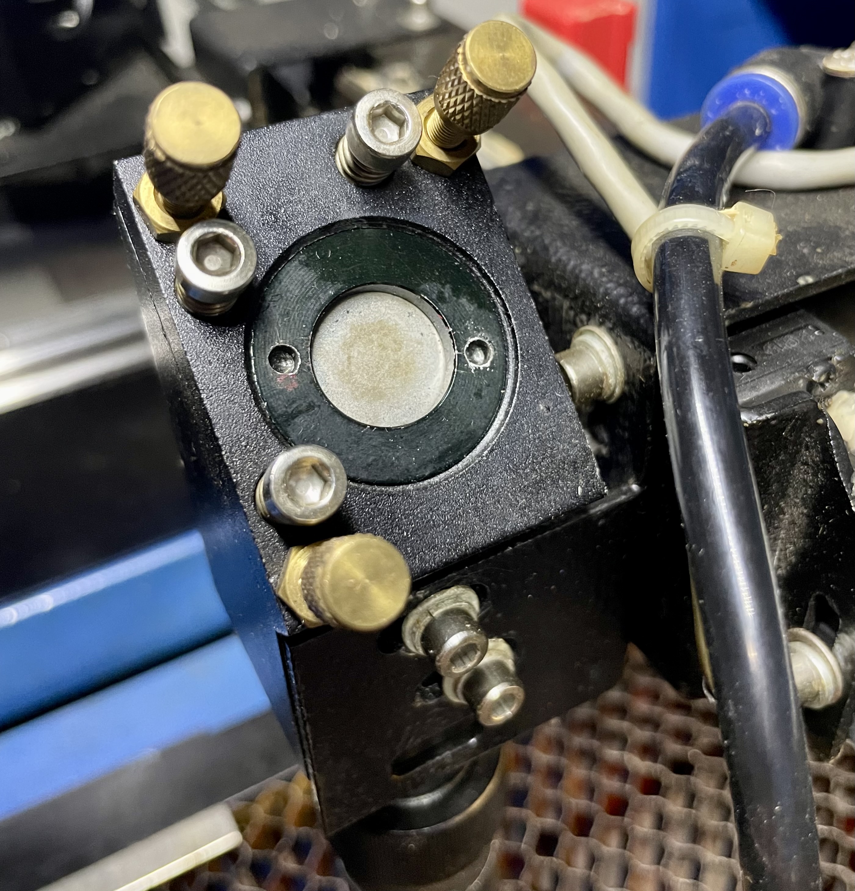

The mirrors on my 50W are held in place by screw-in retaining rings with holes for a spanner wrench to loosen and tighten the rings. Since the mirrors have to be taken out periodically to clean, I needed an easy way to manipulate the retaining rings. Had been using some snap ring pliers, but they aren’t terribly convenient for the tight areas around the 1st and 2nd mirrors.
So, I decided I needed to make a low profile spanner wrench / key. Since this is a low torque situation I opted to just laser cut one from 1/4" plywood.
As best as I could tell, the distance between the holes was 20.0mm and the holes themselves were 2.5mm in diameter. Using some 3/32" (2.38mm) K&S brass rod to make the pins.
