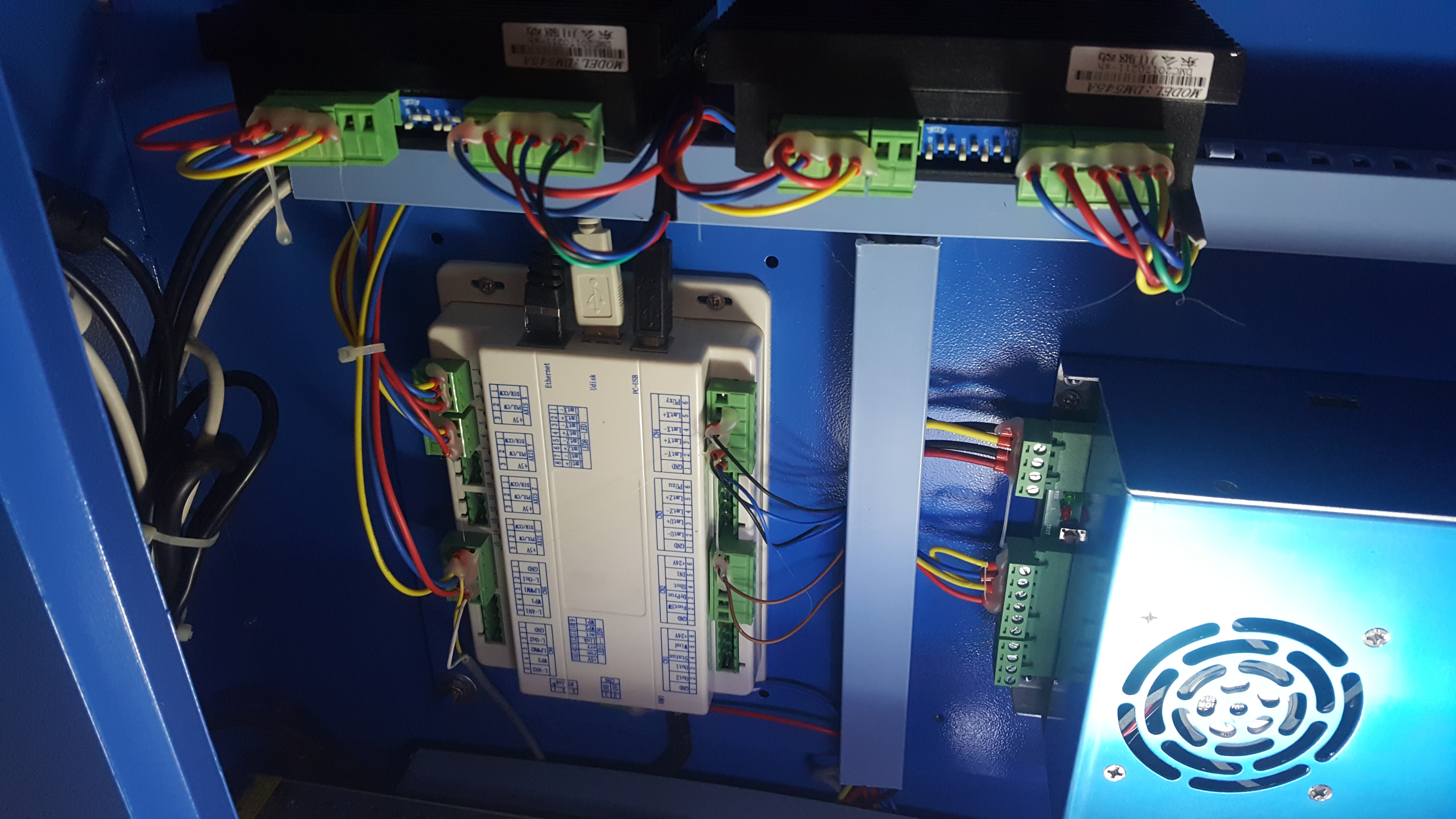

Which controller board do you have? The controller board is the board the USB cable plugs into. If you can’t tell by looking at it you can post a picture of it.
K40 Whisperer is not compatible with that controller.

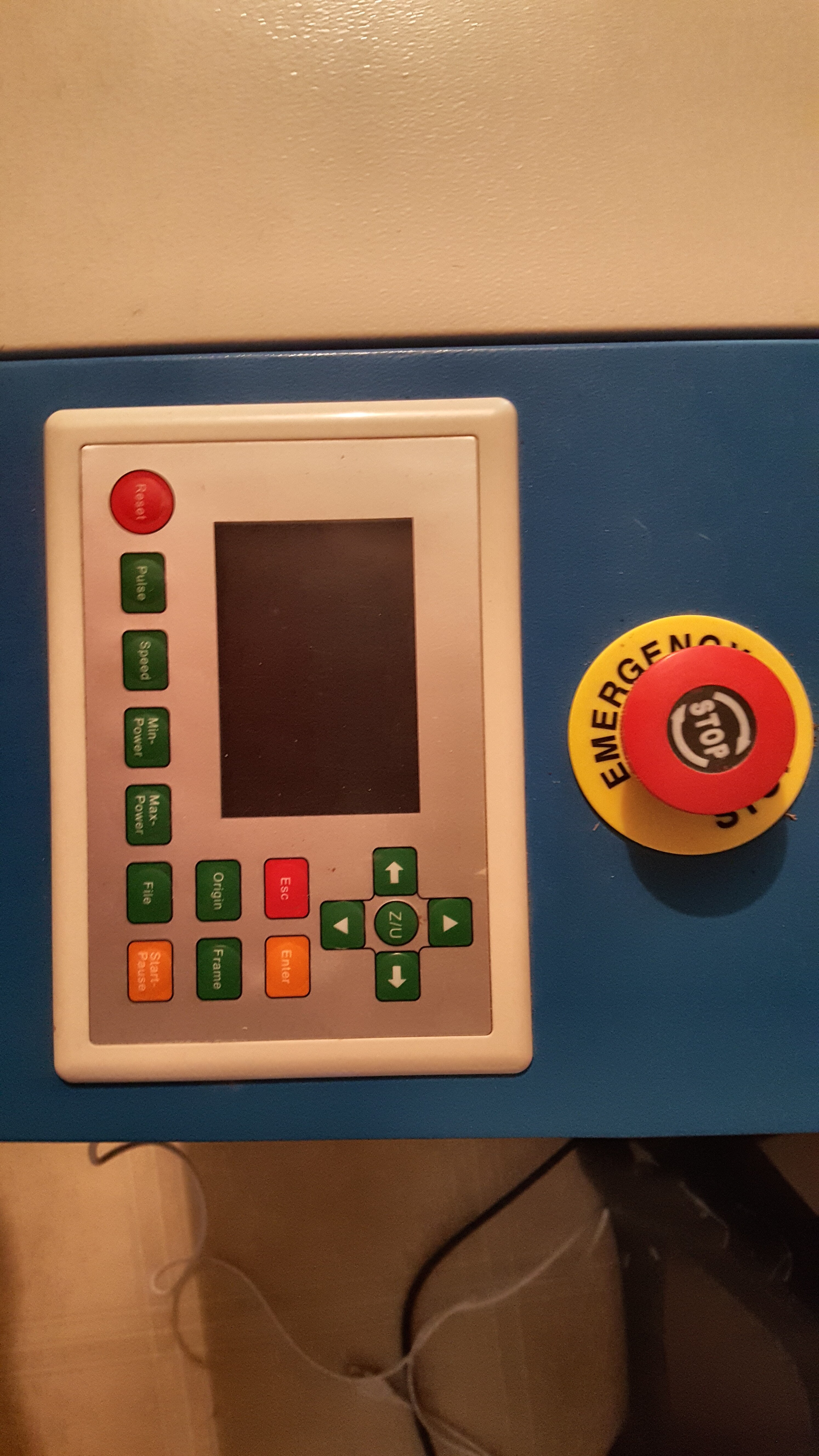

Can you take a picture of the keypad and display?
That is a Ruida controller.
You can use Lightburn which is not free or RDworks which is free and made for the controller. I have that controller and use Lightburn. It is easy to use and has a great forum for help. It is not free but you can try it before you buy it.

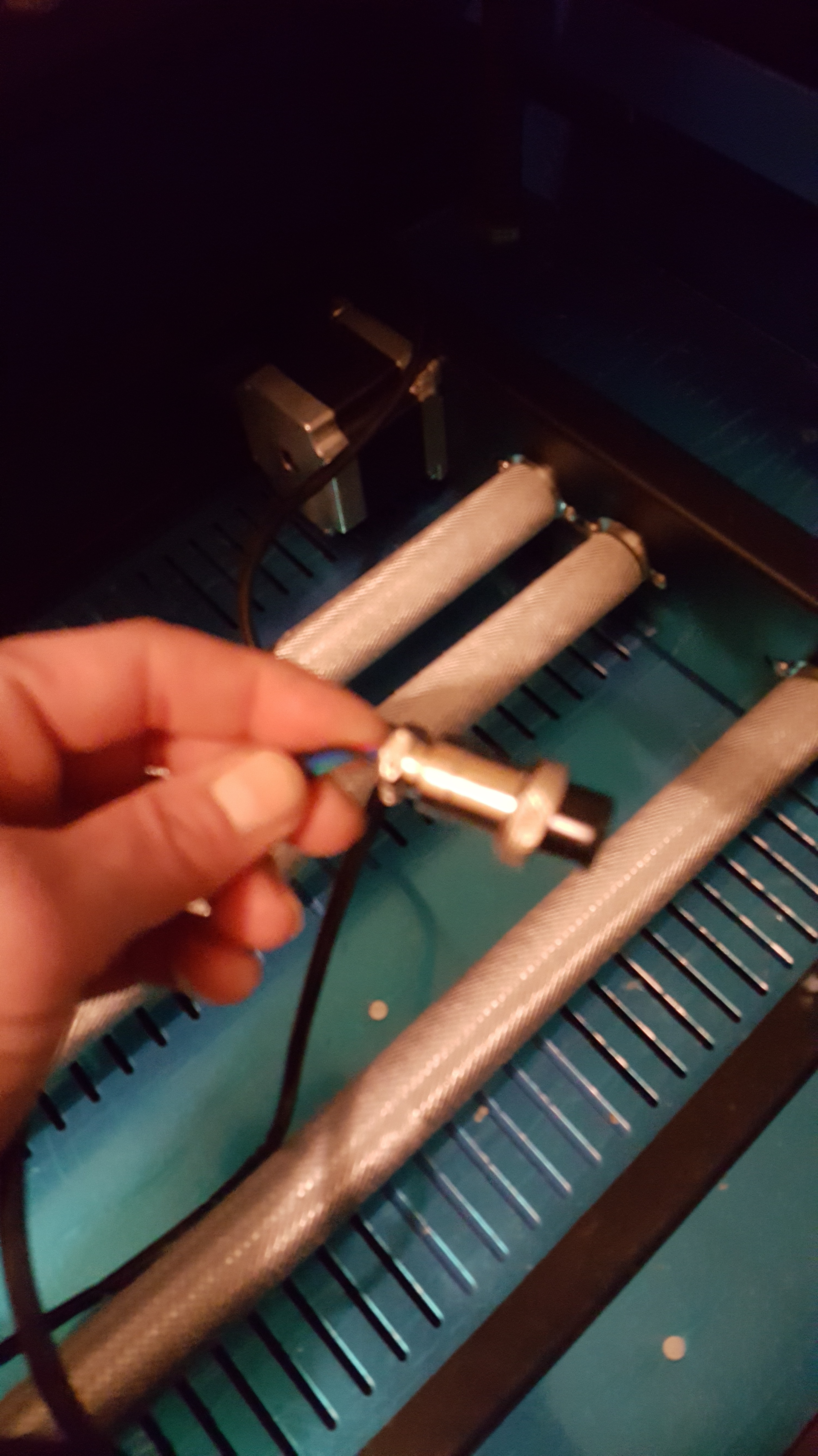

Can you tell me where this goes?
That plugs into where the y motor plugs into. It replaces the y-axis when you’re doing rotary.
