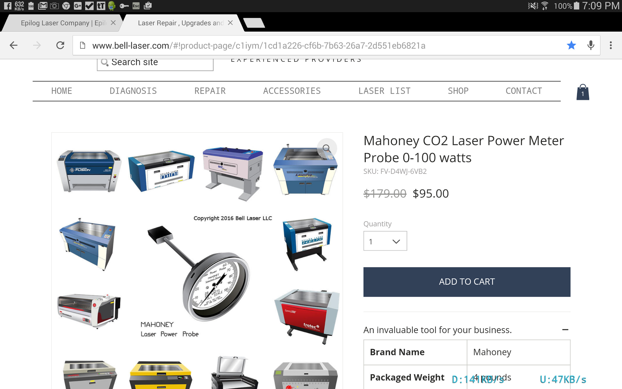

Laser Power Meter up to 100w on sale for $95 http://www.bell-laser.com/#!product-page/c1iym/1cd1a226-cf6b-7b63-26a7-2d551eb6821a
Laser Power Meter up to 100w on sale for $95http://www.bell-laser.com/#!product-page/c1iym/1cd1a226-cf6b-7b63-26a7-2d551eb6821a
Looks like a pretty decent probe for the money. Thanks for the heads up.
Despite my passion for cool tools, it’s hard to justify it for my one laser that I KNOW isn’t putting out 40w. Since there’s little I can do about it anyway, I’ll save the hundred bucks for when my tube dies…
