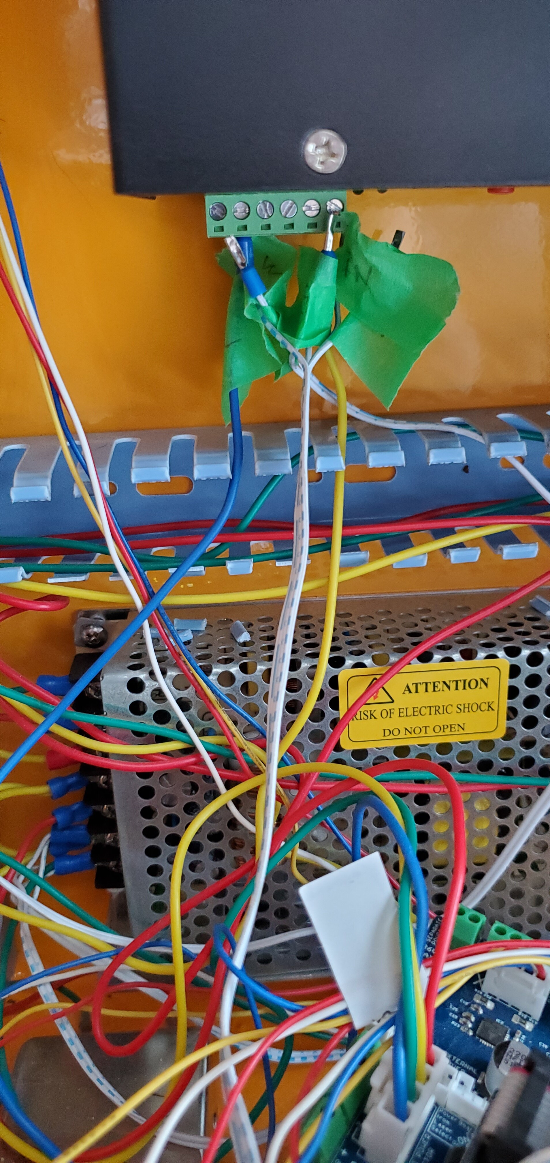

… the connector side of your power supply

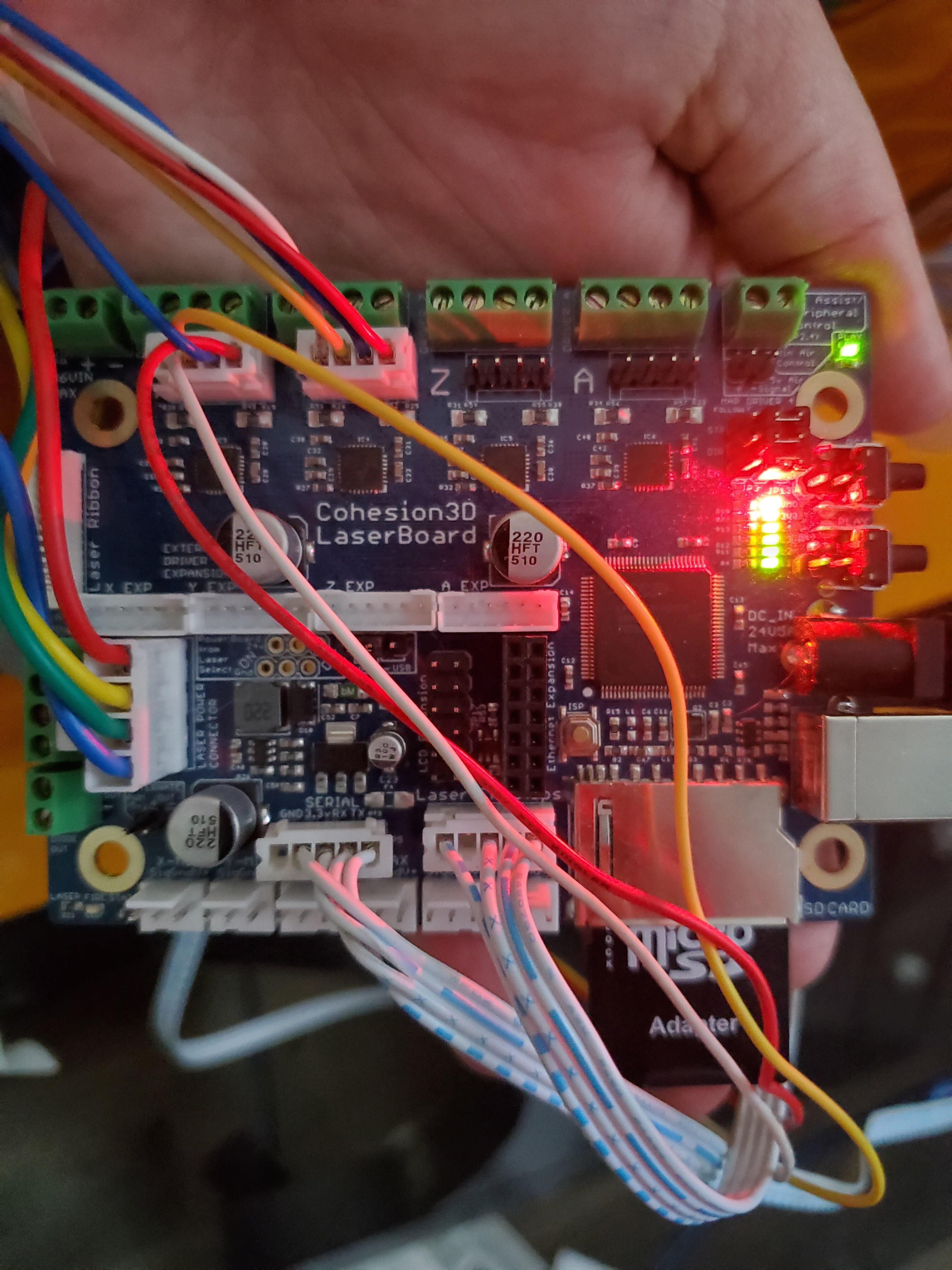

… our control board showing the cabling

To help I need to know how each of the wires on the LPS [left connector] is connected to the C3D.
You can also check the supply by doing the following:
Remove all the wires from the Left-hand connector of the supply.
Wire like this:
- IN connected to 5V
- WP connected to G
- Connect a wire to TL with the other end stripped back…
Temporarily connect the stripped end of TL’s wire to G …DANGER: THE LASER MAY FIRE
What should happen
- The laser should fire when TL is connected to G
- The TL led should blink
- The WP LED should be on.
BTW it’s hard to see the labels on the left connector so a better picture of that will help.

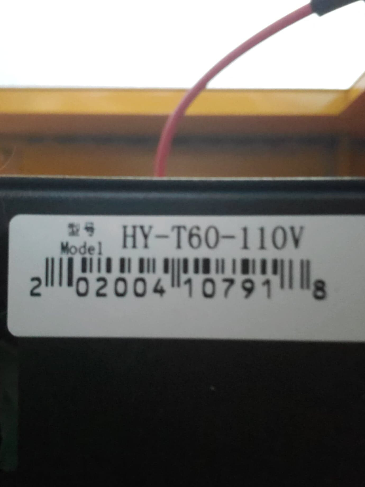

Also the model # for the supply??
When connecting the a wire to TL to G, a the Green(solid) TL LED comes on, but the WP led does not.
The TL and WP were loose and seem to be flattened, should we resolder those connections?
Model # on the laser power supply : hy-t60-110v /202004107918

Did you also connect the WP connection to G?
It’s normal for that kind of pin connections to be flattened when they are tightened.
Yes, we did try the WP to G.
All wires from the LPS are connected through one strand of cord.

I still need some kind of wiring diagram that tells me how the C3D is wired to the LPS???
