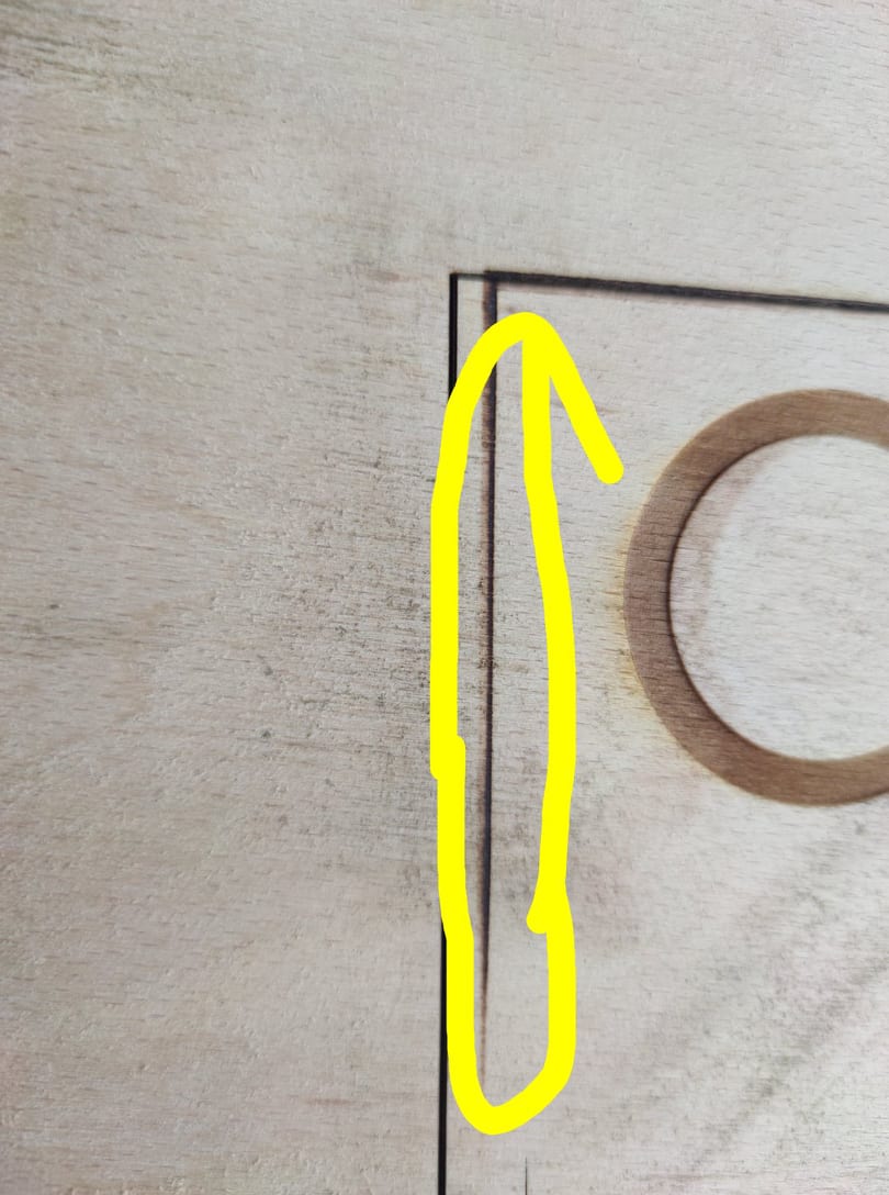

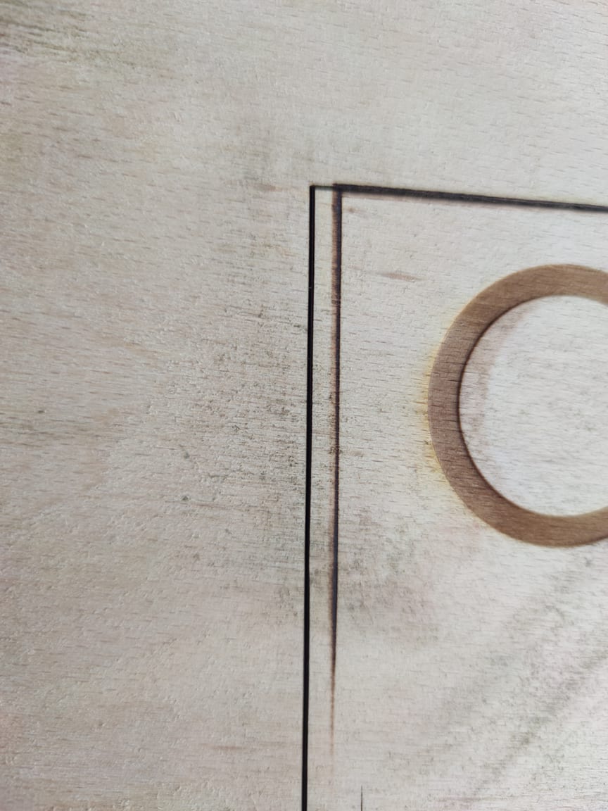

can someone please explain to me why my laser create a parallel line
116430470_205600404226752_1911476572793264646_n|375x500
This is usually caused by the laser beam not exiting the cone correctly, but bouncing off the inside of the cone. You need to align the 3rd mirror so that the beam exits the cone cleanly without hitting the sides.
