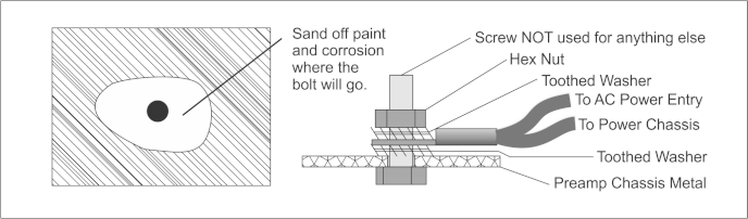

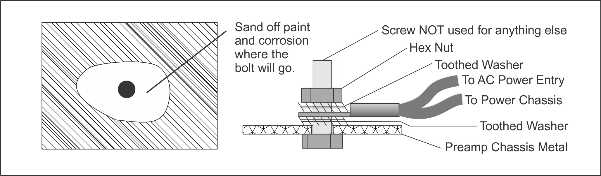

If you determine that you must use the ground plug on the back for safety grounding, then you should make sure that the ground socket actually connects to the metal case by sanding the paint off the case where the ground plug/socket bolts into the case, much like the diagram for grounding below.

The picture below is how I reworked the ground lug inside my K40.
I (@keen) have professionally designed AC powered equipment since the mid 1970s, so electrical safety is near and dear to my heart. So are the legal implications of electrical safety. I must make this disclaimer: This is based on the advice I got from a real, no-fooling safety engineer that did safety inspections of industrial equipment for certification. That being said, I do not know if his advice is enough to ensure safety, and I can not and do not recommend that you use this for your machine. I merely present it for your consideration. If you do it this way it is at your own risk, and you take all responsibility for your safety doing it this way. I trust this for my safety, but you must decide on your own about your safety.

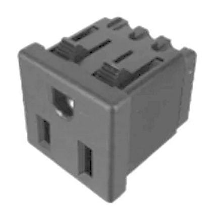

New electrical outlets on back: If you plan to use the electrical outlets, they need replaced with three-wire outlets. I used Qualtek 739W-X2/32 that I bought from Mouser Electronics. They cost me US$1.28 each. They required me to cut and file a rectangular hole in the back of the K40 for each one. This has to be the correct size, so some skill in placing and filing the holes to the proper shape was needed.
