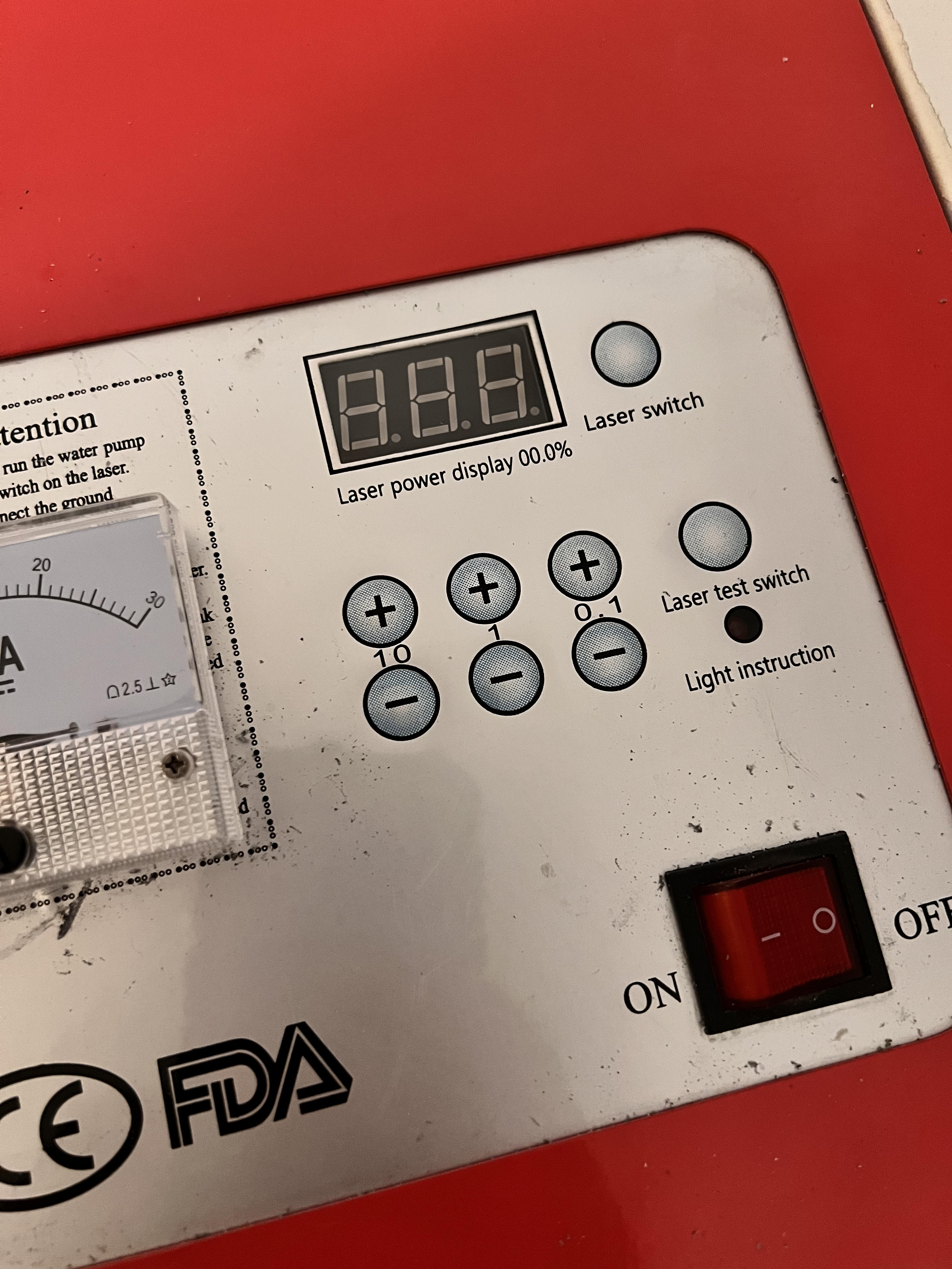

which Test Button?
As @dougl asks we need to know what test button you refer to above?

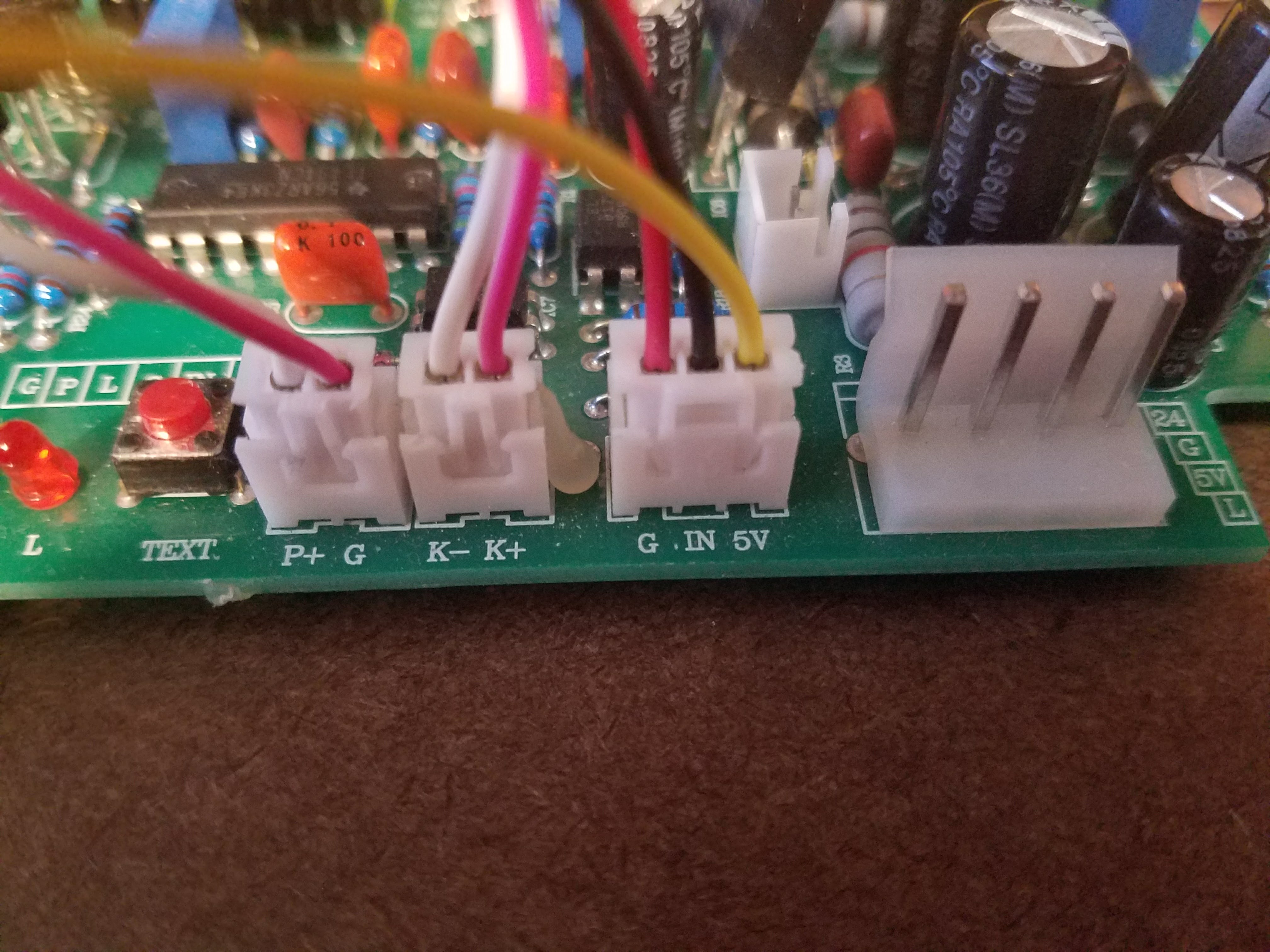

Also please post pictures of:
  • Control panel
  • The LPS showing the connectors
  • The controller showing as much wiring as possible.
The symptoms suggest a problem with the control of or the internals of your LPS.

Here the pics.

BTW, the LPS stands for Laser Power Supply. It’s the think in the middle picture. Do you see the red button next to the wire terminals which says [TEST] ? This is the ‘Test’ button you were asked to press and see if the laser still stops firing.
There are two ways you can manually fire the laser:
  1. Laser Switch on the panel, provided the Laser Test switch is on.
  2. The red test switch on the Laser Power Supply (LPS).
As @dougl suggest press and hold the Red LPS Test Button and see if it exhibits the same behaviour as with a job.

If the LPS test button does the same thing then I would look really close at the AC power wires and connection from your wall outlet to the LPS and make sure there are no breaks in the wires at the connections. The thought is some heating after a few seconds could open a circuit. If your motors run and all is ok except for laser firing then it’s a slim chance even that’s the problem. Next I would look really close at the wires from the LPS to the laser tube, out the laser tube, to the amp meter then back to the LPS.
If those are all good then my guess is the LPS is failing. Final test would be to remove all but the power button, jump 5V to IN signal and jumper the safety switch pins and try the LPS test button one more time. If it still stops after a few seconds. It’s probably the LPS. I would also refer to what Don says. He’s debugged probably a hundred or more machines.
So it appears that the LPS is shutting down for some reason but we have pretty much eliminated the controller as the source of the problem.
The red test switch on the LPS bypasses all of its control signals other than the IN power control.
Your LPS looks like this type.
We will run some tests, one at a time so they do not get mixed up.
Test A. Lets see if the LPS is shutting down when the laser stops firing. We are going to watch the red led on the LPS to see if it stays lit.
  1. Set the power to 50%
  2. Verify the red LED [to the right of the red test button] is illuminated. If not… do not complete the test and let us know
  3. Push and hold the LPS test button to start the laser firing.
  4. Observe the red led on the LPS.
  5. While holding the test button and when the laser stops firing does the LED go out or blink.
