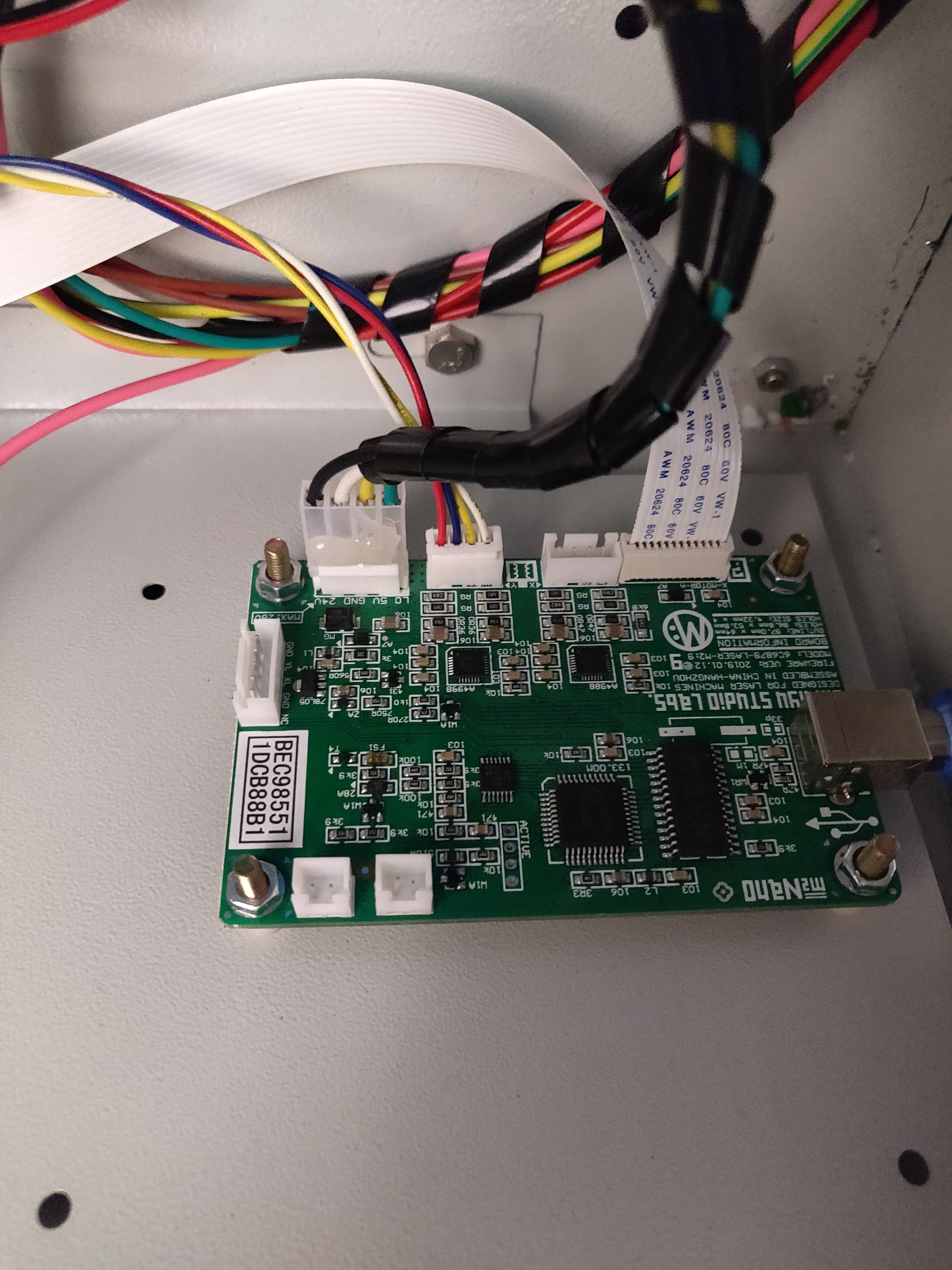

Please provide these pictures of your machine:
The control panel
The connector side of your LPS
The wiring between your controller and the LPS
The back of your control panel showing the wiring

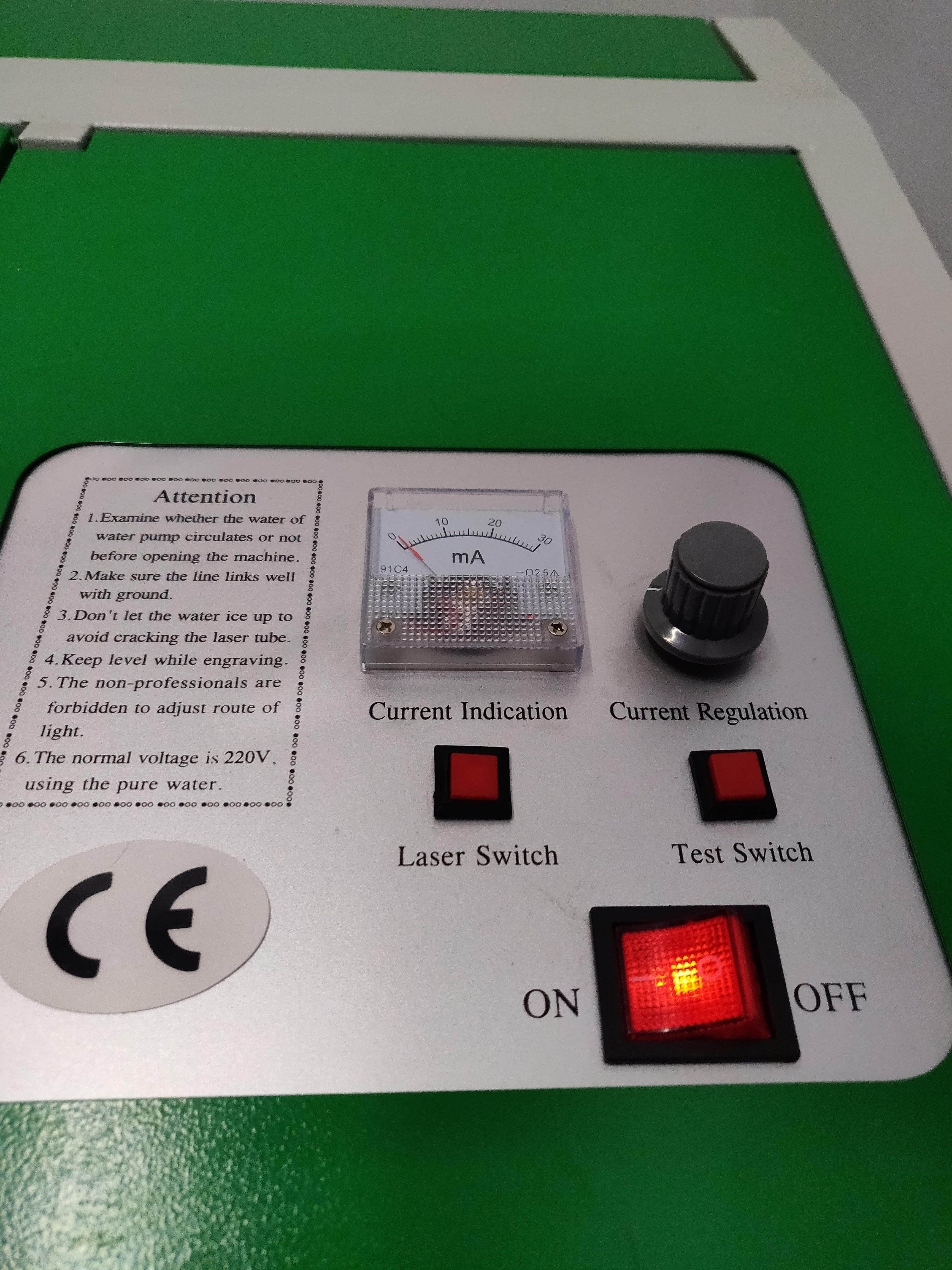

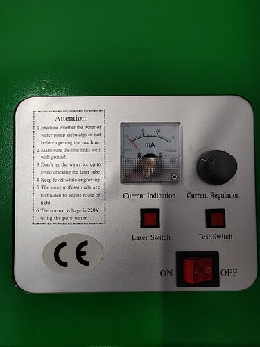

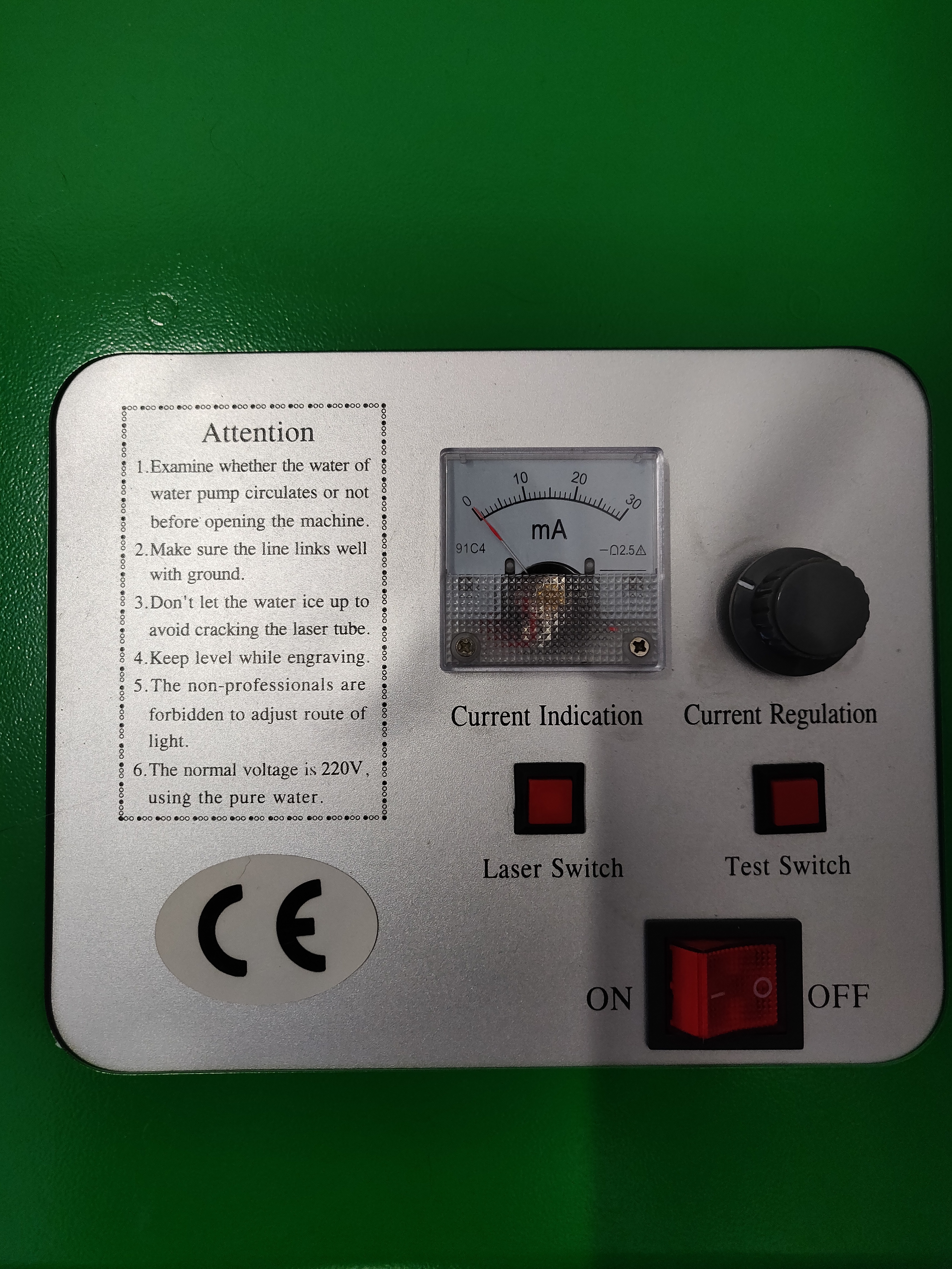

NielsA
(Niels aertgeerts)
March 4, 2021, 1:22pm
3
I hope this is wat u ask fore .
donkjr:
button
Tis is the test switch u see on my panel the laser switch is on and with the test switch it works
donkjr:
job
I tested a few images and a basix square with a circle and a star insite al in the colors to vector cut or vector engrave or raster engrave non works .
Thanks fore the help

Thanks for the pictures.
Have you tried imaging with the stock software?
Can you post a picture or video of the panel while the job is running?

Yes a view of the control panel. A photo will work just take it while the job is active.
donkjr
(Don Kleinschnitz Jr.)
March 4, 2021, 2:05pm
8
Your current regulation pot seems to be set a minimum?
Turn the pot up past the middle and see if that changes anything?

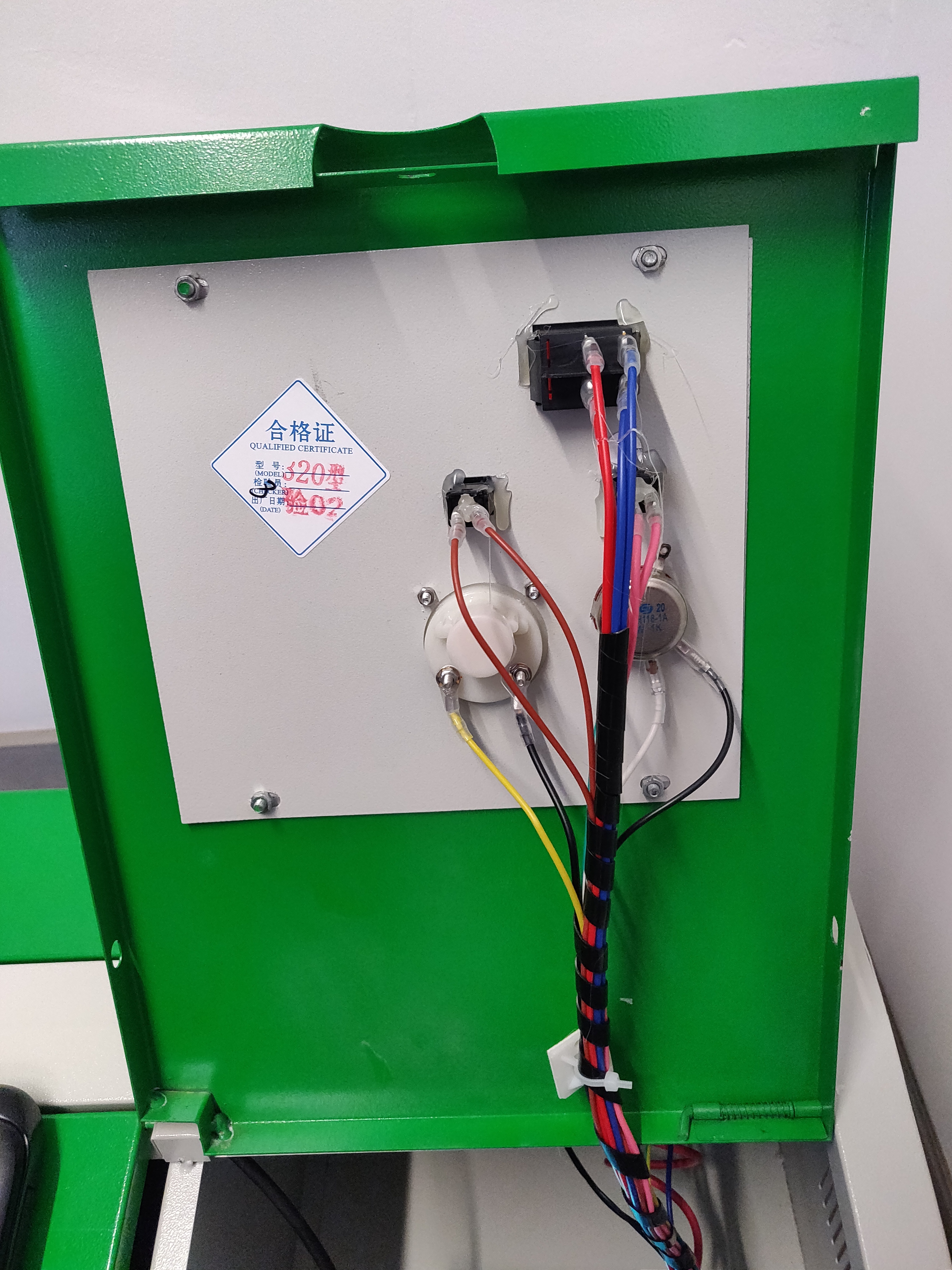

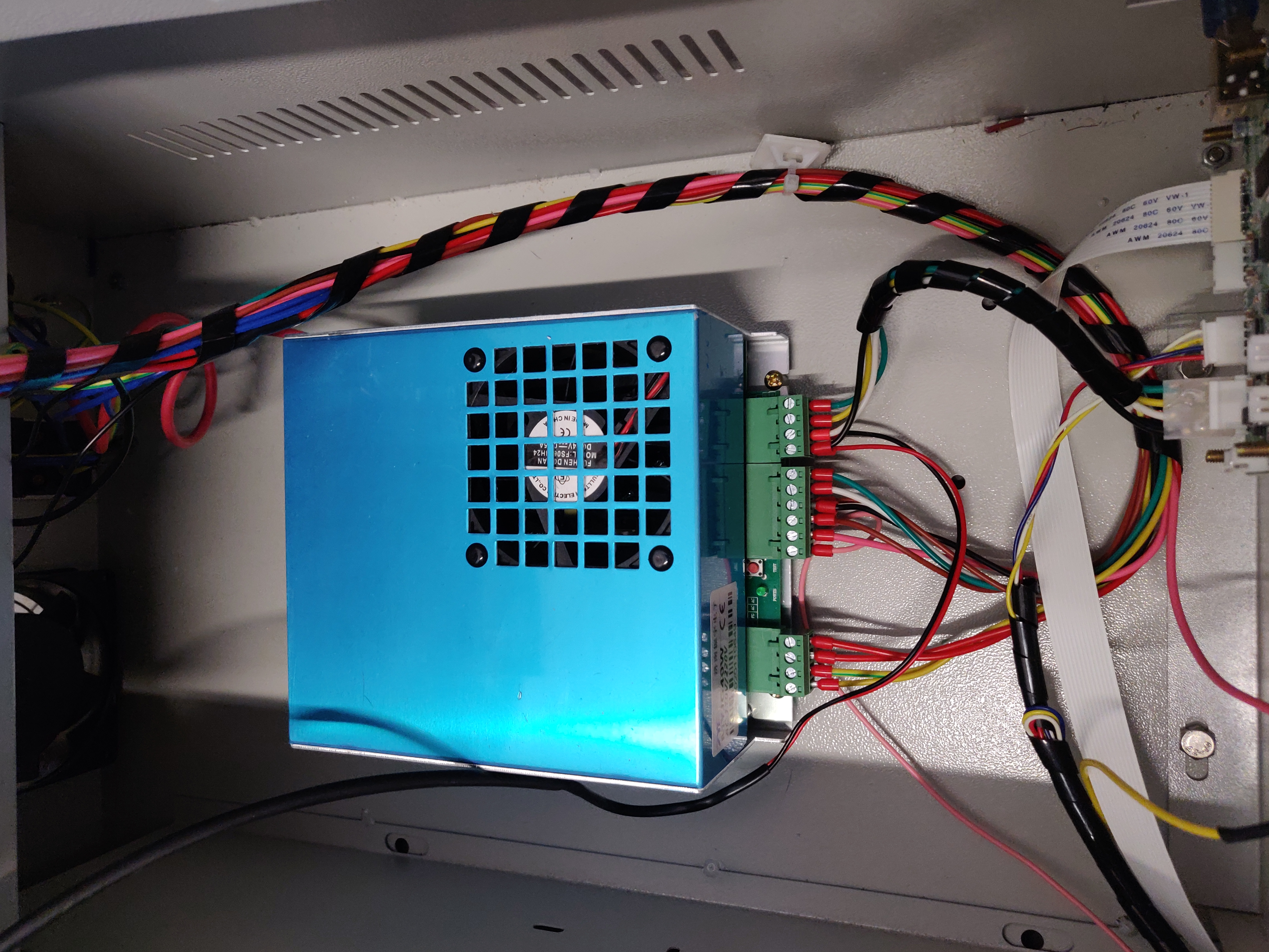

Scorch
(Scorch)
March 4, 2021, 2:47pm
18
From the pics it looks like the laser switch and test button wires are swapped.
@donkjr can you look at the pics to verify?
donkjr
March 4, 2021, 3:00pm
19
Oh my not again !!!
I am checking…
donkjr

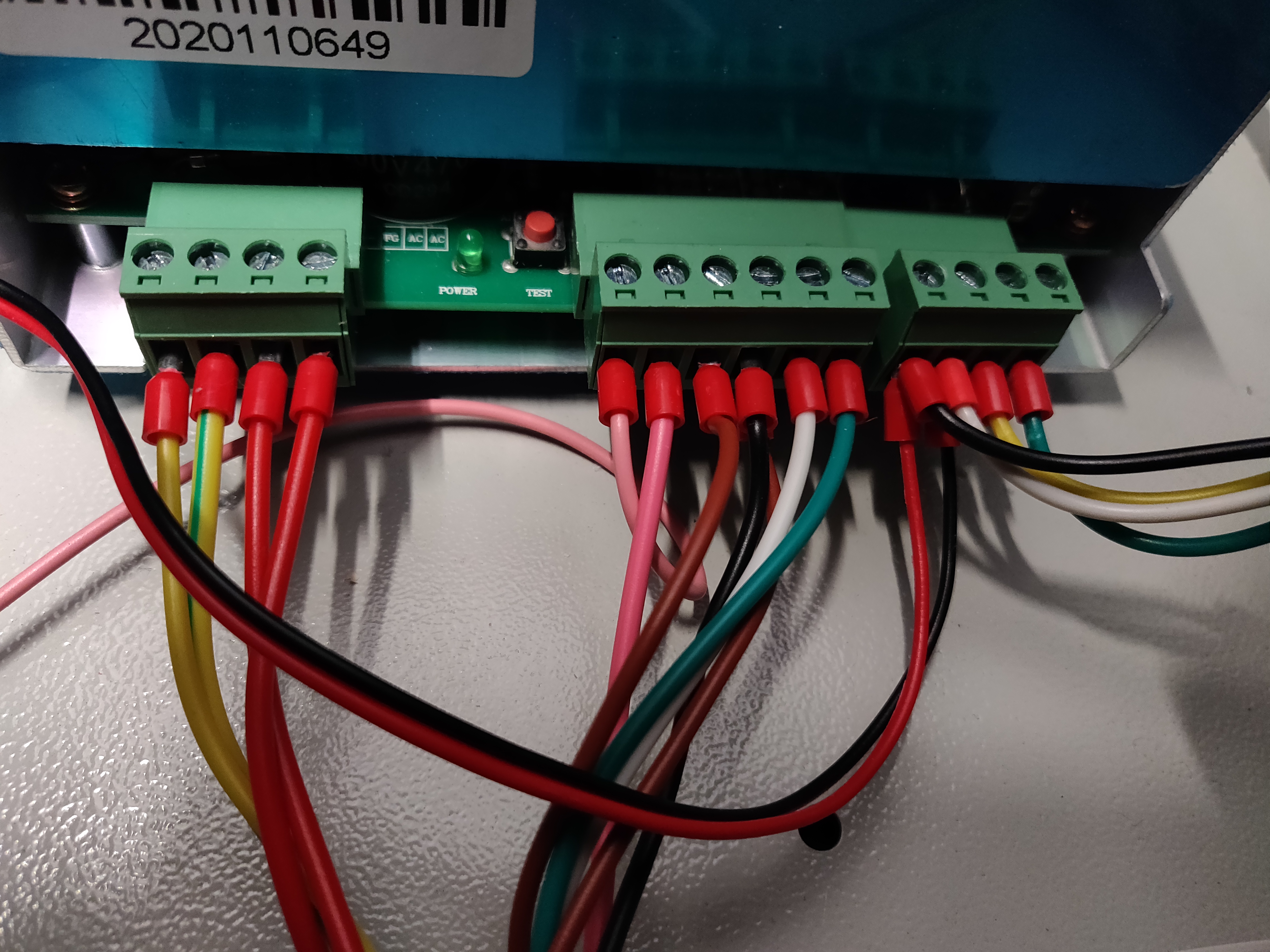

March 4, 2021, 3:25pm
20
Yup, the wiring is swapped! Wrong up on the panel this time!
@NielsA swap the wires that go to the “laser switch” and the “Test Switch”
Should look like this:
