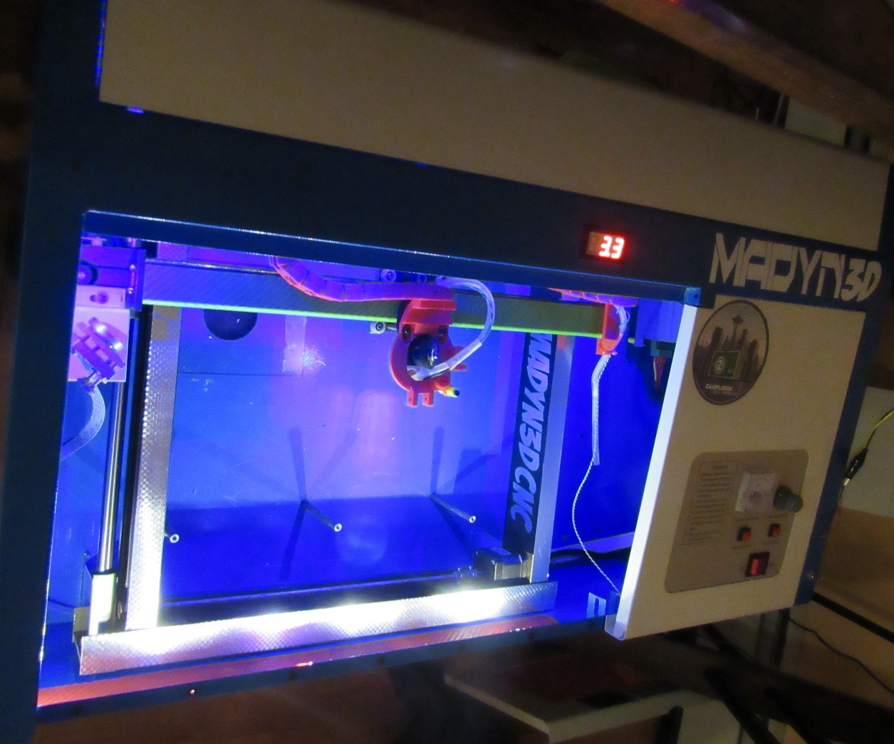

Lasers and dance clubs are somewhat synonymous, except I don’t do dance clubs so this is as close as I’ll get.
Doing some stuffs, thought I’d share.

@Kelly_S this one was pretty rough as well with MDF sap/soot and acrylic resin, in fact it was even effecting the bearings it was so thick. I am replacing the laser tube so I took advantage of the downtime to hold it’s 1st annual cleaning, 91% iso cut right through the MDF and acrylic crud, then detailed everything with over sized q-tips I swiped from the doctors office a while back, then re-lubricated everything with 100% propylene glycol (PG).
