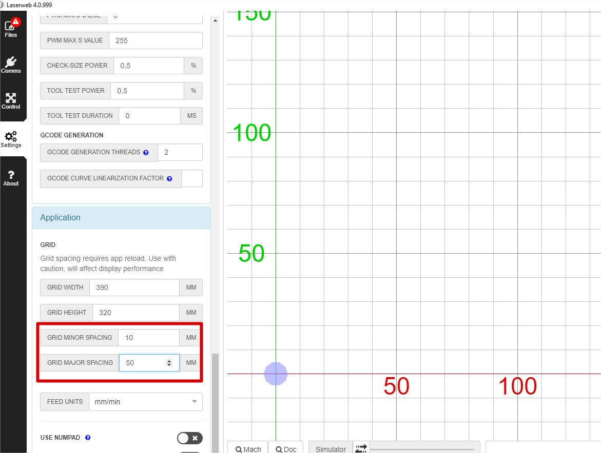

When I change the gridspacing under “Application” all of a sudden Laserweb halts.

There is a bug/workflow error going on as you edit the value, it think it gets briefly set to ‘0’ as you start typing, and this causes LaserWeb to lock up as it tries to draw an infinite number of grid lines in your web browser.
And, even worse, it has saved this value to your local machine settings in the browser. So if you restart laserweb the bad settings get resurrected and the app instantly hangs again.

You can use the up-down arrows beside this field to adjust it safely, just never let the value get blank or 0.
For posterity:
The issue is not actually with the grid lines, it is with the grid numbering. Which is continually re-drawn as the value is being edited.
The line drawing routines have a (simple) protection mechanism that limits the value to 1mm even if it is set lower in settings. But the grid labelling routine does not have this, and can get stuck in a loop trying to draw the same number repeatedly.
