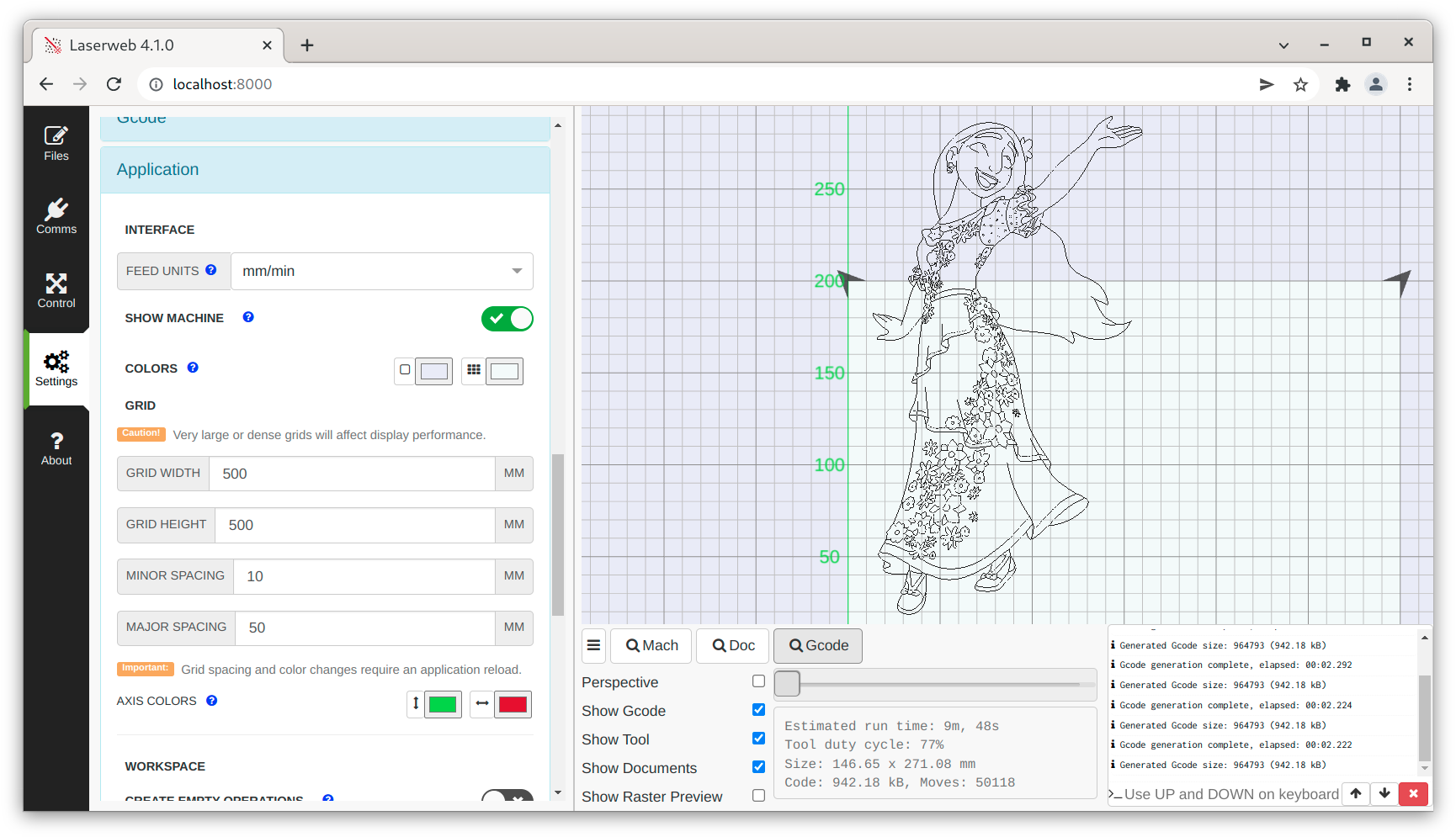

Edit: I strongly suspect a cache problem… since the grid settings are definitely moved from machine to applications settings in the latest version…
Hi,
It must indeed be something related to the cache. I can start either the latest git clone (version 4.1.0) or the one from February (version 4.0.999) and Chrome still shows me whatever was last from cache. If I open up an Incognito tab in Chrome it is not affected like normal tabs. However the machine and application stored parameters are not available in the Incognito tab.
Funny thing now, I have started up the 4.0.999 server but the 4.1.0 is in the cache, I can run and generate GCode. Even asking Chrome to reload the page doesn’t fix it. I’ve seen options to disable the cache altogether in the development console, but for me it doesn’t even work, cached version is still loading.
In order for the correct version to load, I had to clear the browsing data but only Cached images and files with an All time range in Chrome.
Not sure if I’m the only one affected by this, but maybe we should consider cache busting. That link is kinda old (2014) but anyway, food for thoughts.
Now that things are back on track on my side, I can confirm items 3 and 4 on my original punch list are now in good order. I also like the fact that the server connects up to the machine as soon as you open the Comms panel.
I’m going to suggest a patch for lw.comm-server MPG soon. After that I’ll be able to dig on the force-closed/rogue line reported in another thread.
In Chrome Open the developer tools (rt-click->inspect) and leave them open, mimnimize if distracting. Then go to the refresh page icon in the URL bar and long press it. Select ‘Clear Cache and Hard Reload’, this is the safest way to load a page when developing.
These are browser caching issues; and I don’t really see them; I test a lot on Chrome, Chromium and FFox without issue… I dont have time to go through all the discussion here, chrome is deciding how to cache the page based on heuristics… the way to override these is to set the correct headers when serving the pages.

Hi,
I tried the python script, went back and forth between the two commits and unfortunately it doesn’t work on my Debian install with chromium 99.0.4844.84. The trick with Empty Cache and Hard Reload does however work.
Anyway I feel this is more a development annoyance as a normal user wouldn’t be affected except during version upgrades. I suggest to add a warning in the readme to clear the browser cache when changing versions.

The revised Python script does the job on my setup.
