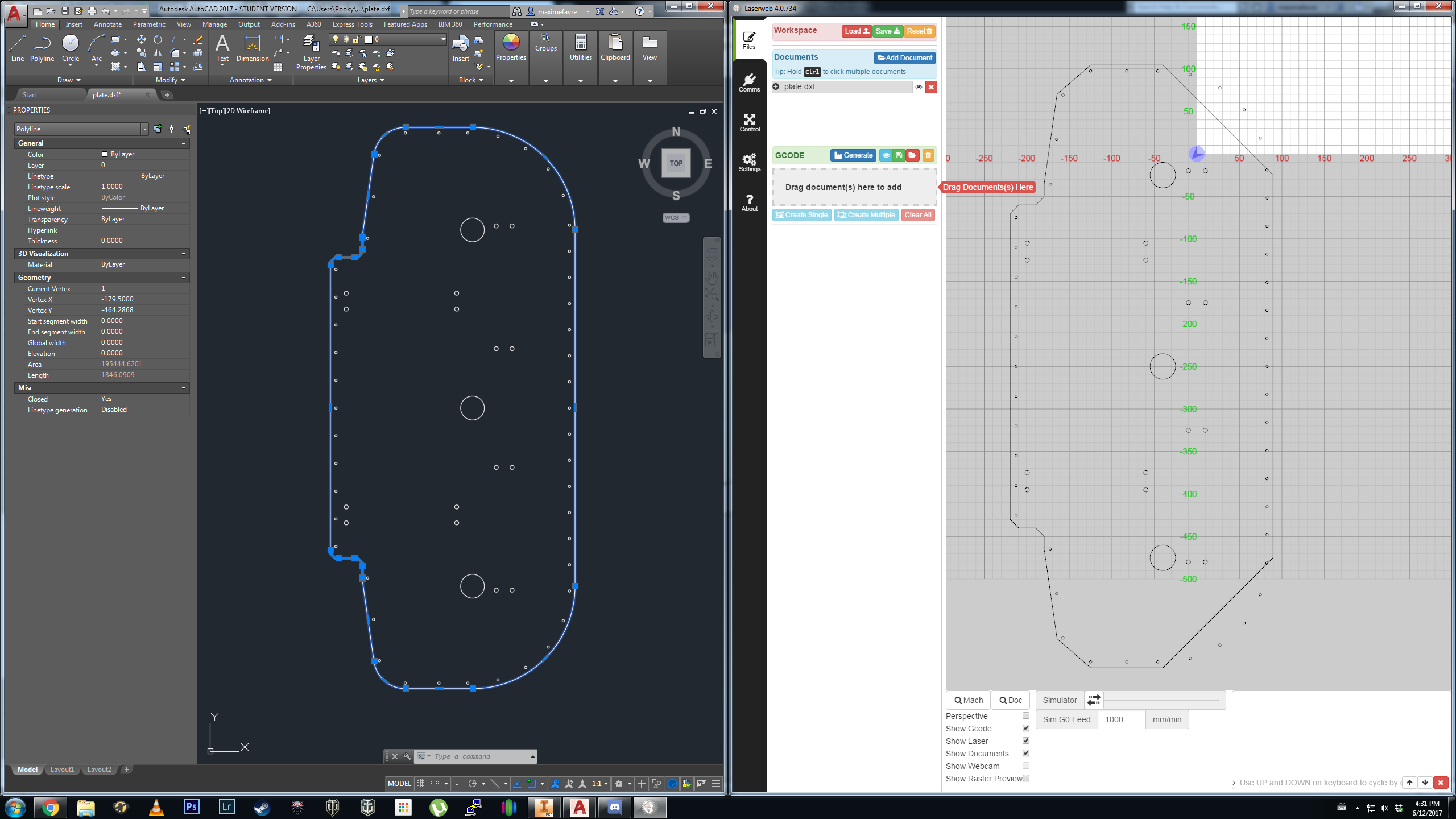

Laserweb doesn’t support arcs ?!
Tried many dxf export version but my arcs are converted to diagonal lines no matter what.
Using last version v4.0.734-96
Nevermind, probably an export glitch from the 3d file to dxf (inventor). I re drawed the arc manually in autocad and they display fine.

Nup. Does not support arc representation yet. But the cut will be fine, as long as the machine hardware does.
