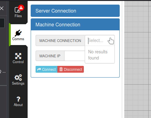

however I still have a question, but it can also be that I have misunderstood somthing. If I access the server from another PC through the web browser, e.g., http://192.168.1.155:8000, I cannot see the machine or any port but I can see it on the local laptop where the server is running on.
Is there a setting that allows me to still see it there, or is that an error? Because if I understood the graphic of the Communication structure [1] correctly, I should be able to control the server and the CNC machine from anywhere in the local network.

ah sorry i made a mistake, it didn’t connect to the correct server under Comms and i thought it was automatically connecting to the correct server and not trying the localhost.
In any case, thank you very much for your previous answer, I had earlier given up trying to do it through node v18 but now everything works.
