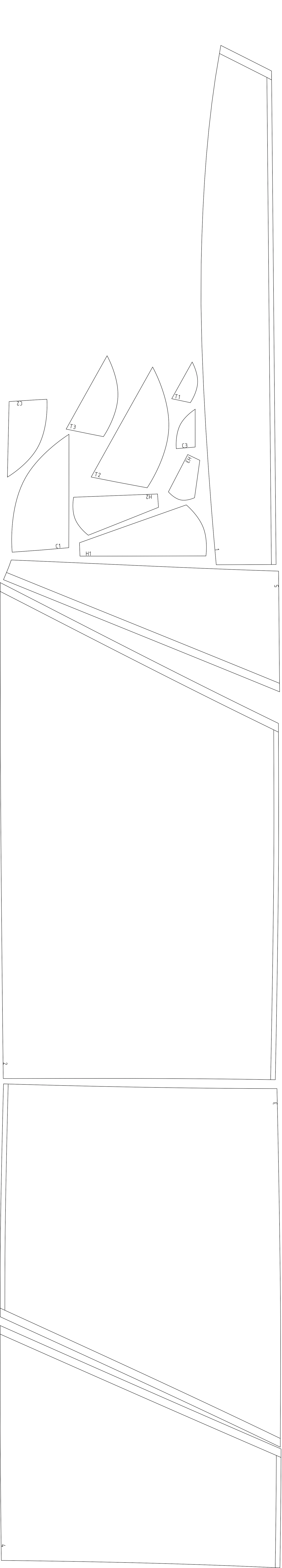

thank you for your reply. Well the drawings are very simple, only vector lines but big scale 1x5m. I’m attaching one example.
Ok, that shouldn’t make any problems.
