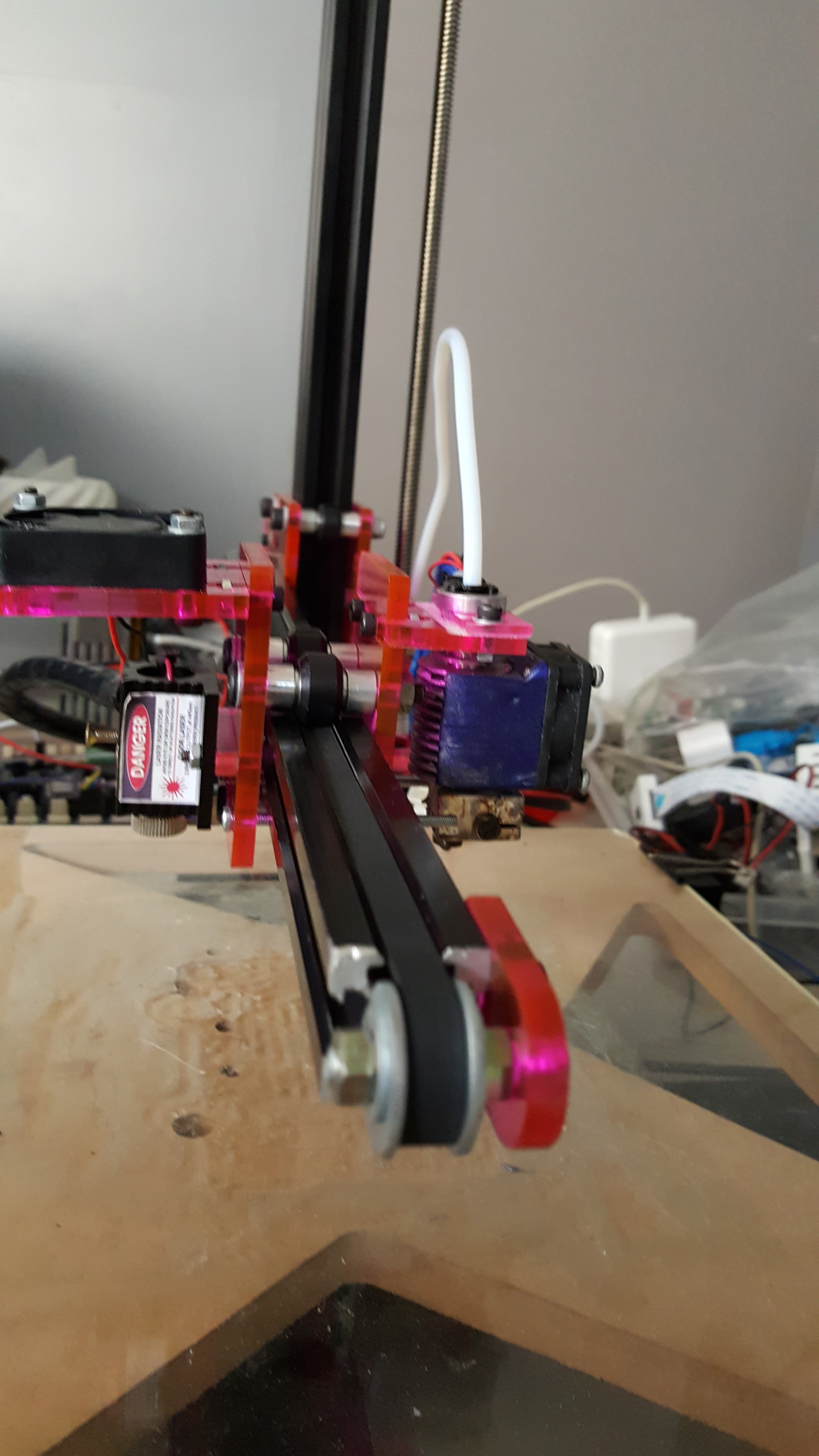

LasrPrintr - Not a single 3D printed part. Work in progress.
LasrPrintr - Not a single 3D printed part. Work in progress. Some detail to finish and hookup

@Step_Cia your hotend mount on this printer. What do you think?
@raykholo ​ not @Step_Cia ​. This is all acrylic I started building 2 month ago. I’m just finishing some details
@Ariel_Yahni_UniKpty you’re funny. I was referring to this:
https://plus.google.com/+StephenCia/posts/XgdWWumA9qm
I have not come up with custom plate yet so far. The plate I’m attaching the hotend to is from openbuilds so I have to work around those to make it work. Good thing they published the .STP files so I can design the holder to fit nicely.
Btw @Ariel_Yahni_UniKpty ​ is that pc molex fan connector you use for the hot end?
Looks awesome. But the question is. Why no 3D Printed parts?
@Step_Cia ​ yes it is. But I feel it’s to big, form my previous printer which was 16x16x24 it seemed suitable
@VolksTrieb ​ using a laser cutter that’s costs less than most 3D printers and can product parts much much faster. All this is nice until I prove it works
@Step_Cia ​ I was going to use this as a solution for the cabling. Attached it to the back side of the carriage
