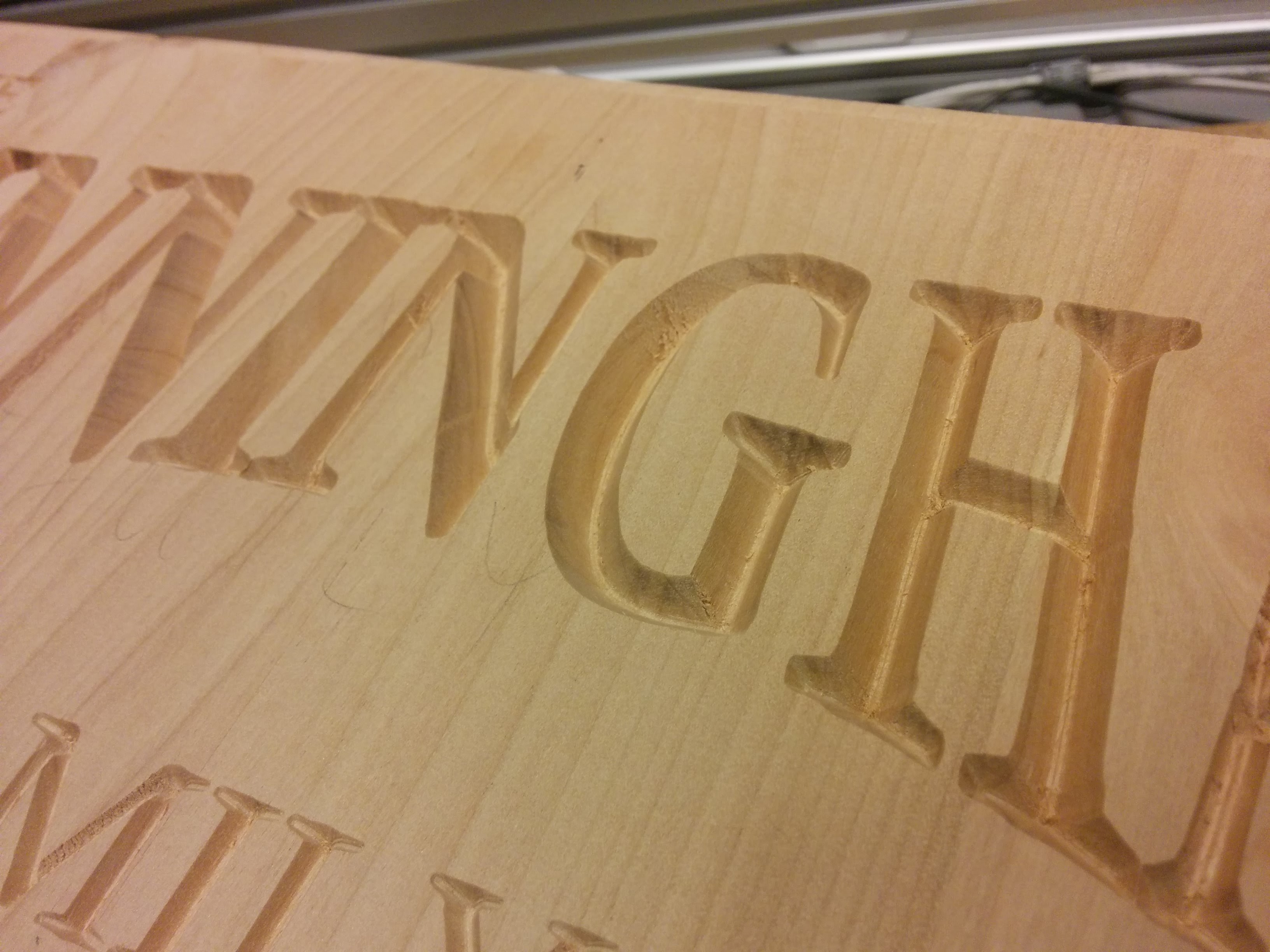

Last nights progress on a family sign for some newlyweds!
