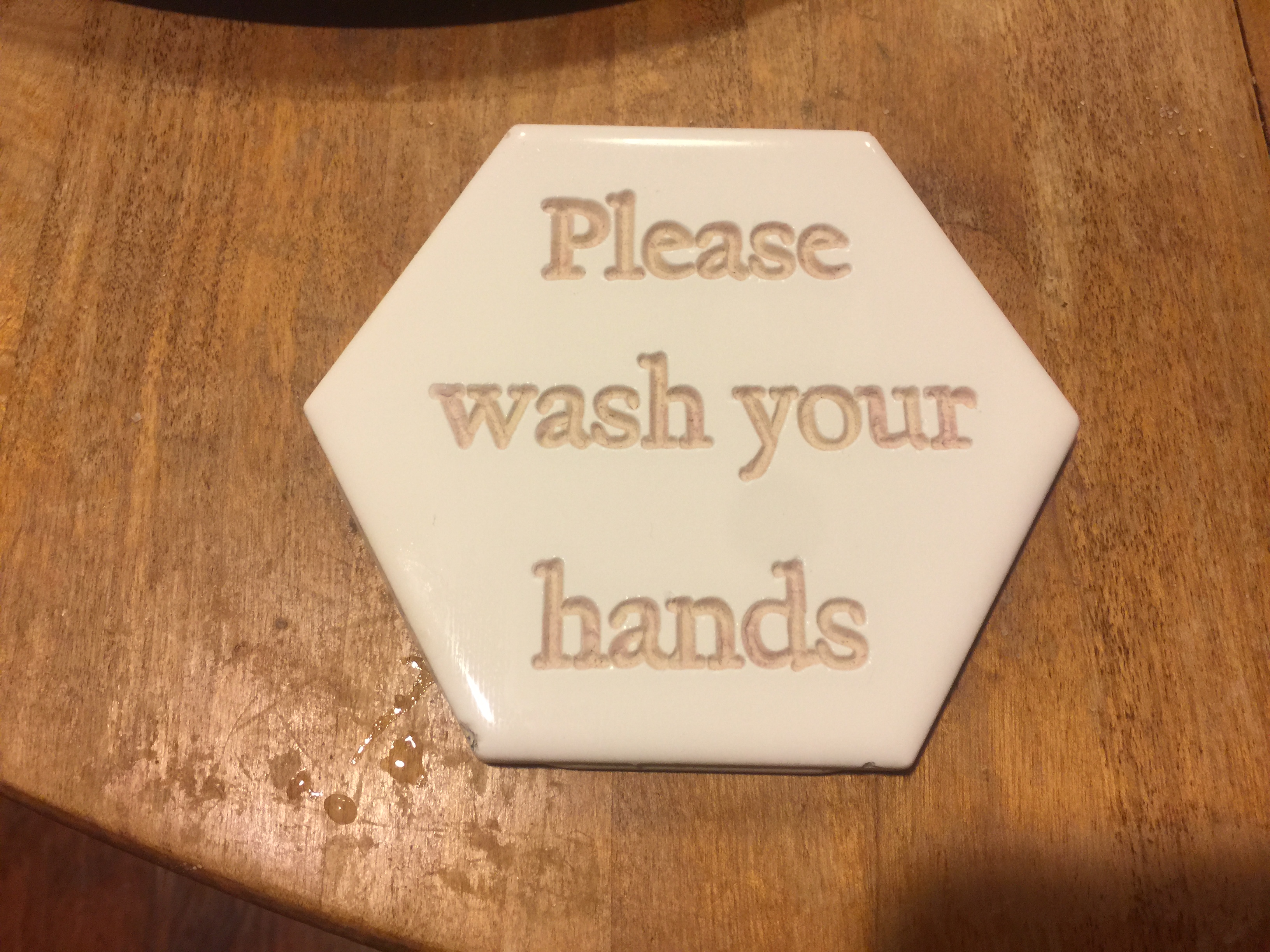

Last project of the day:
Hardware store tile drill, 3000 rpm, 1in/min feed .5 in/min plunge. Fusion 360 engrave tool path. .070 depth of cut in two passes.
Thank you for the speed/feed info. We should gather more of this info together for new makers looking for some starting points.
