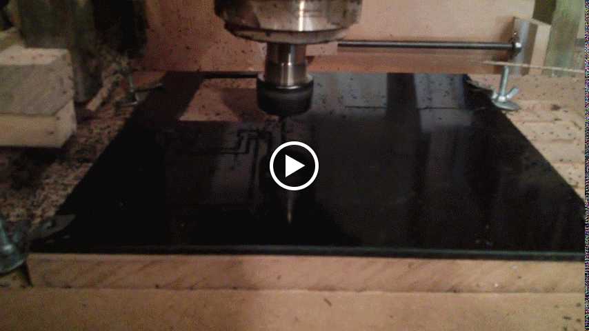

Today I decided to go with the pibow multi-layer case cut from some hdpe sheet.
Things went OK, on the bright side I could run the spindle down at 6000rpm and didn’t have any melting problems. However I tried to push it a little fast and one of the x axis motors started stalling on one of the layers.
I think it went well enough. Tomorrow I’ll try to get through more layers and look at cleaning up the edges of the cuts.
