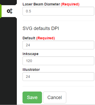

I just tried out the DPI. All my files are created in Inkscape… It correctly loaded it at 90dpi, but it still shows it in the CAM as being at 25.4 If I edit the DPI field, it starts behaving correctly&consistently.
Interesting… If I open ONE file, the DPI field incorrectly says 25.4 even though it clearly loaded at 90. If I open MULTIPLE files, everything works exactly as expected.
The cam field is there to change at will, maybe we need to add the correct loaded dpi so it clears the confusion?
Yeah. The value shown should match the value used.
I look at it tomorrow, need investigation…
@Richard_Betel Fixed ! please test.
confimed based on @Richard_Betel Issue
Its fixed. Thanks!
