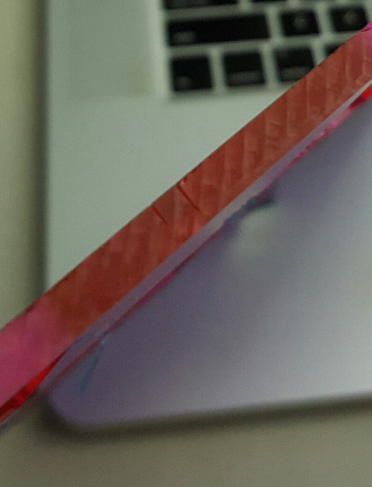

Latest experiment. I got myself a temp gauge and read 31C on my 5
Latest experiment. I got myself a temp gauge and read 31C on my 5 gal bucket, so I decided to run a test. Measure at ambient and then drop in some cold on the bucket, it reached 25C. It seems I can gain some important cut depth. Same settings, speed, cut location was used
