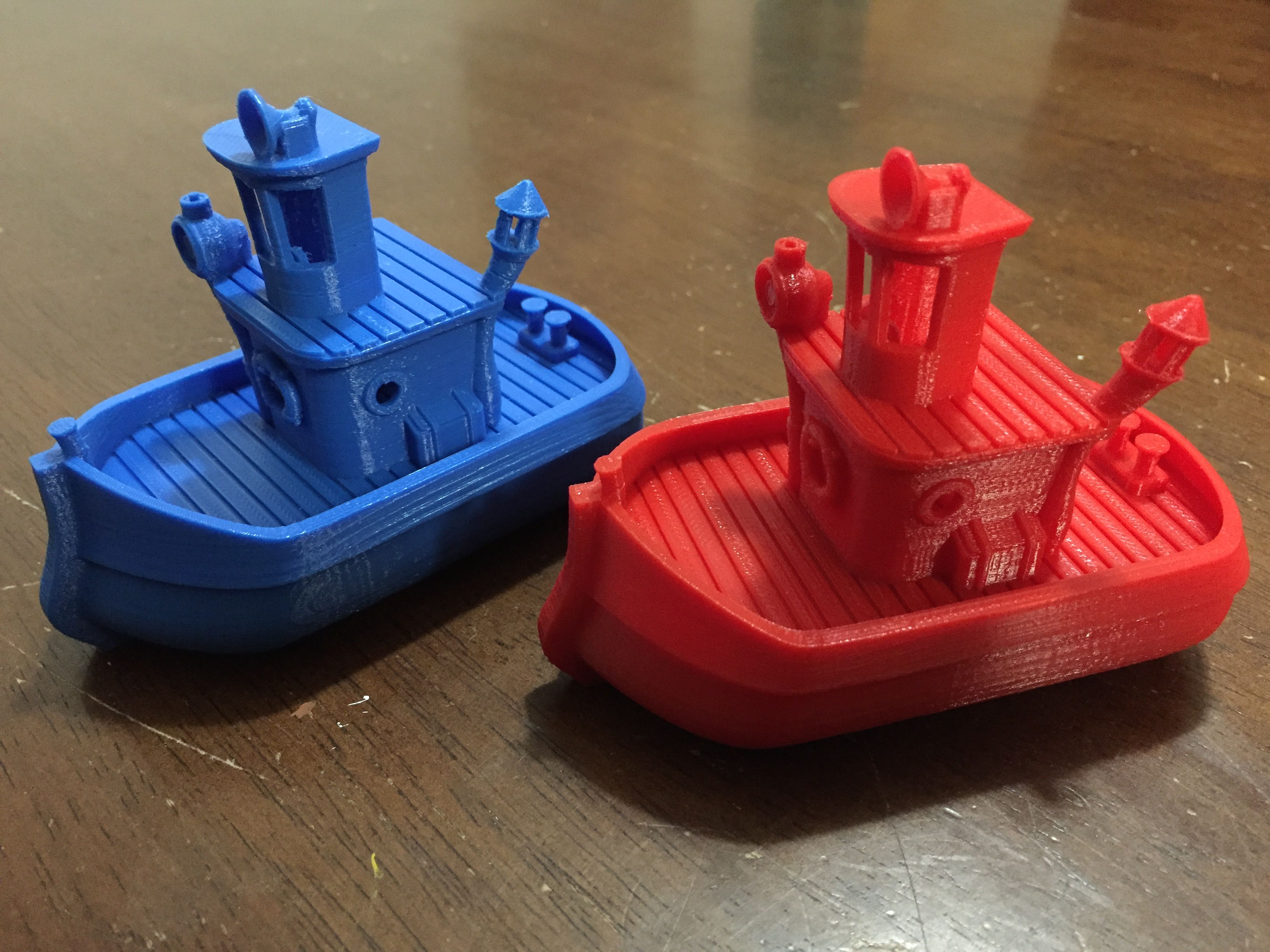

Latest prints for my Grandsons. Two bathtub boats from Thingiverse.
Latest prints for my Grandsons. Two bathtub boats from Thingiverse. They look good and float great. With a good infill they are quite stable in the water.
Printed on an RB3 (ReliaBuild3D Regular) at 0.1mm layer height and 24% infill. No support material required. PLA from Vortex 3Dp.

What infill did you use?

@Aaron_Spaulding I used 24% infill. There is very little infill in the top section so increasing it pretty much just made the hull heavier.

Another testament to your skills! Very nice finish!
