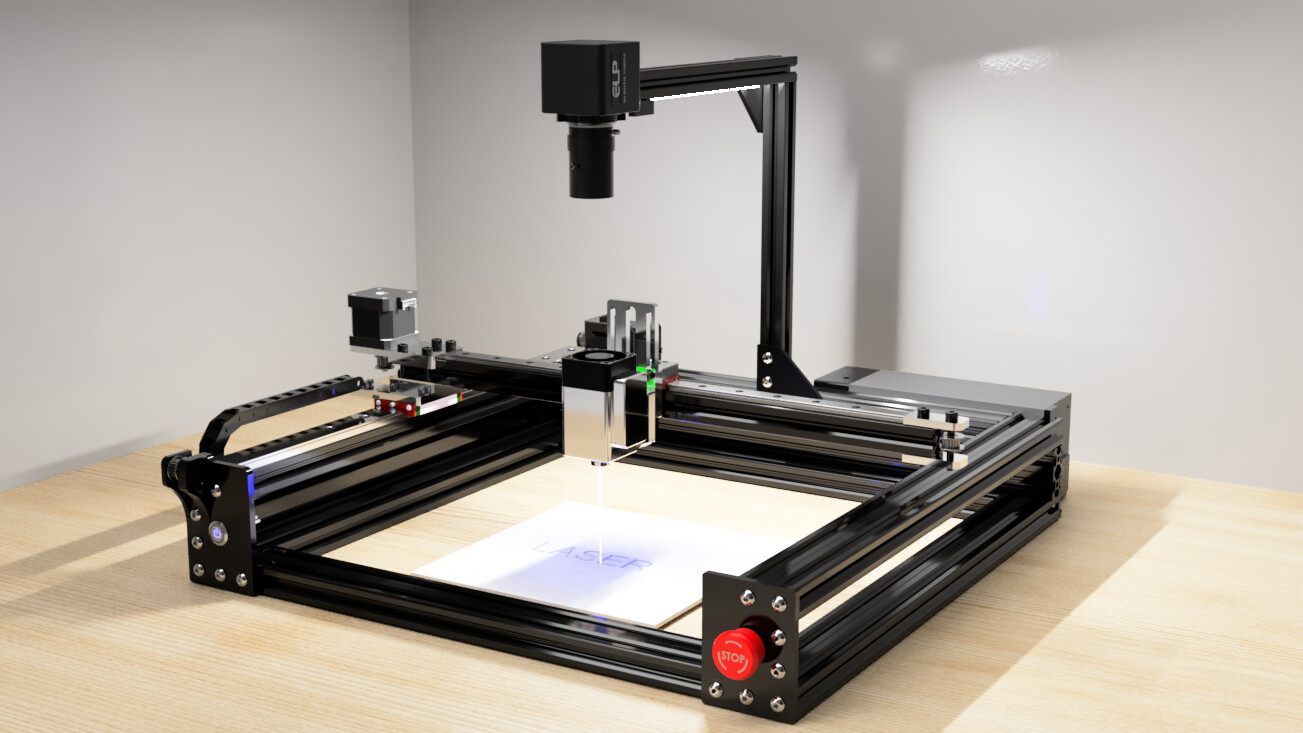

I have designed my own Laser engraver/cutter
I
I want to test the Smoothieboard v1.1 running the clustering firmware
