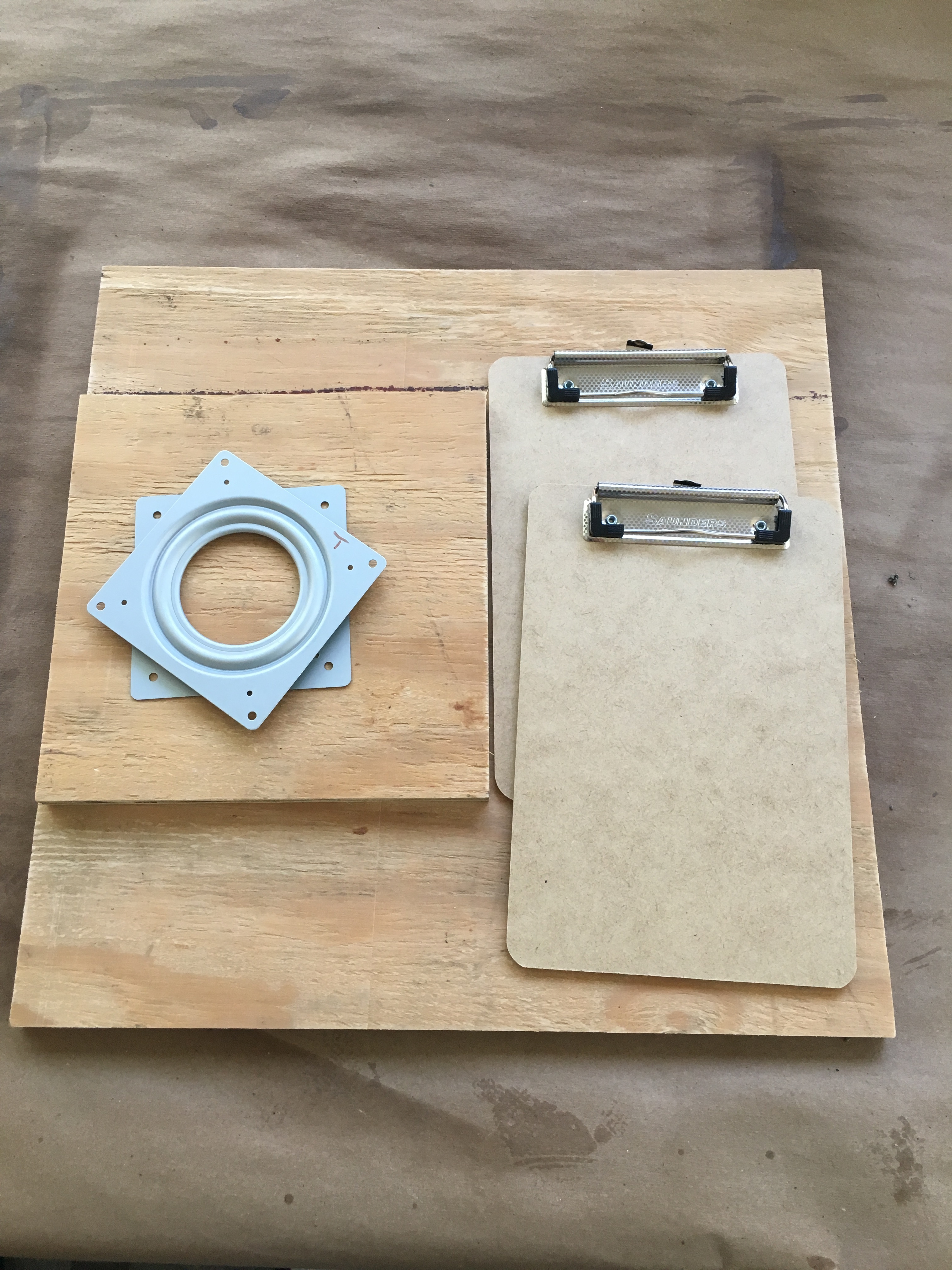

Material List:
  • Lazy Susan Turntable base. They come in all sizes but I opted for a 4" base. I got this one from Amazon.
  • 1/2" Plywood (you can use other thicknesses but 1/2" is good for the screws)
  • 2 Clipboard clips (This is optional, but I wanted the ability to clip on a some paper over the top if I wanted to. I got 2 small press board clip boards from Walmart for ~$1.30 each.)
  • 8 #8 x 3/8" pan head screws. ( You only need 4 if you’re not going to add the clips.)
  • 4 #6 x 1/2" self tapping sheet metal screws.
  • 4 #8S flat washers.
Build:
I cut a 8x8" base and a 15x15" top from the plywood.
Next I carefully drilled out the rivets on the clipboards to remove the clips.
Each side of the lazy susan has 8 holes, 4 large and 4 small. If you rotate the halves 45deg you will see that one side has just the 4 bigger holes accessible while the other side has all 8 accessible. The side with just the 4 large holes will be directly screwed to the top from underneath while the base is attached using the 4 small holes and countersunk self tapping screws from the bottom. Laid everything out and maked the hole locations. Using a 3/32" drillbit I drilled about 3/8" deep into the top location holes and drilled all the way through on the bottom location holes

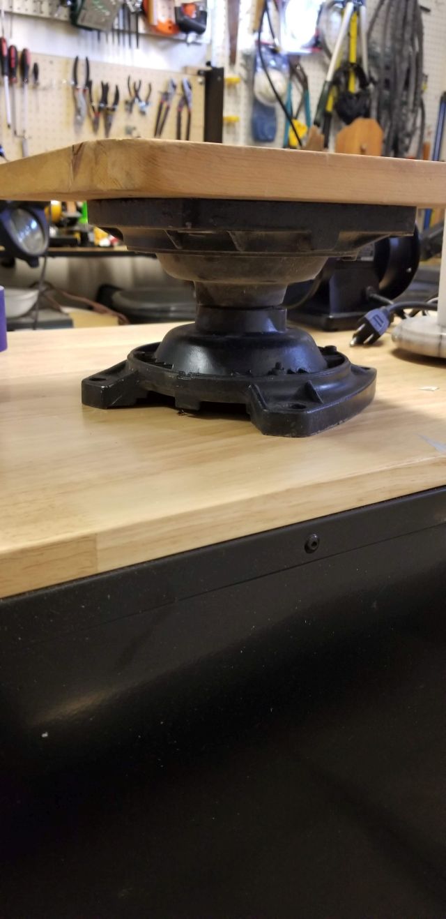

Here is one I a friend gave me. It is made out of some automotive parts. I use it in my $10 Walmart Kid Tent paint booth.
Nice. The tent is a great idea.
