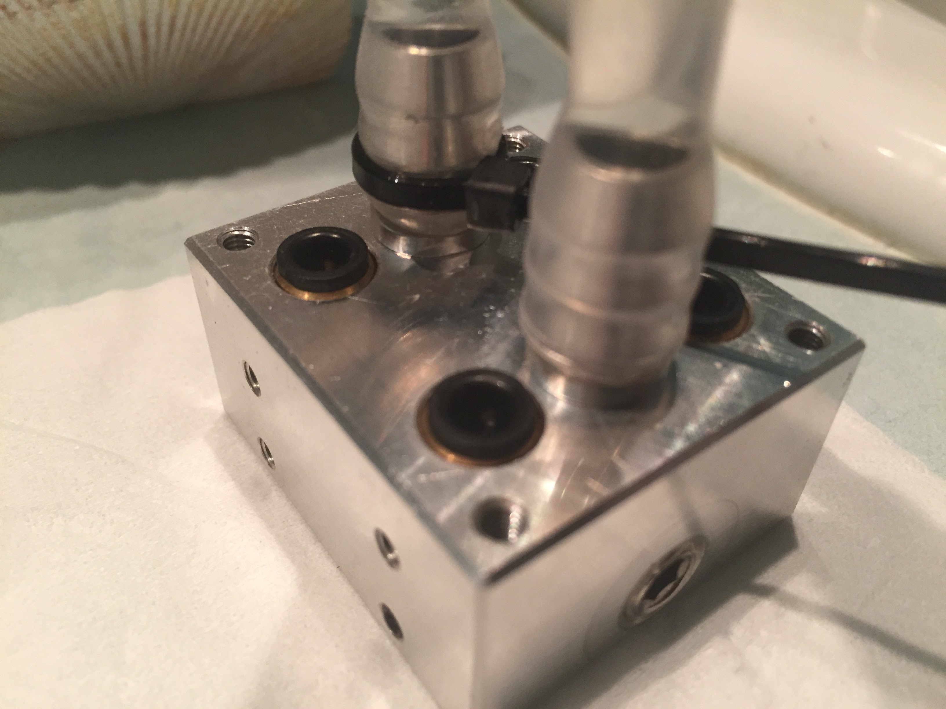

Leaky kraken. Time for new teflon tape on the barb threads.
Leaky kraken. Time for new teflon tape on the barb threads. Any tips for getting the old stuff off?
I’ve used a torch before. Just melt it. Lol. Might turn it a little black though. Honesty, when I run into this issue I usually just add more tape. Lol. You just gotta fill in the cracks.
…brass wire brush!
I just use a pick on it usually.
Brass wire brush for the teflon tape residue. If there is melted filament stuck in there (from leaking?) I use a soldering iron to heat the block up and then wipe it out with a q-tip.
Water cooling hose barbs, not filament heat break barbs :slight_smile:
Ah! makes more sense. I’ve not used a Kraken before so I wasn’t sure where the issue of leaking would show up. :slight_smile:
I’d be hesitant to burn it off, the thermal decomposition products of teflon are really unpleasant. You could probably just slap more on, honestly.
Thanks all for confirming, wire brush and peel approach worked, combined with nature’s pick aka my fingernail.

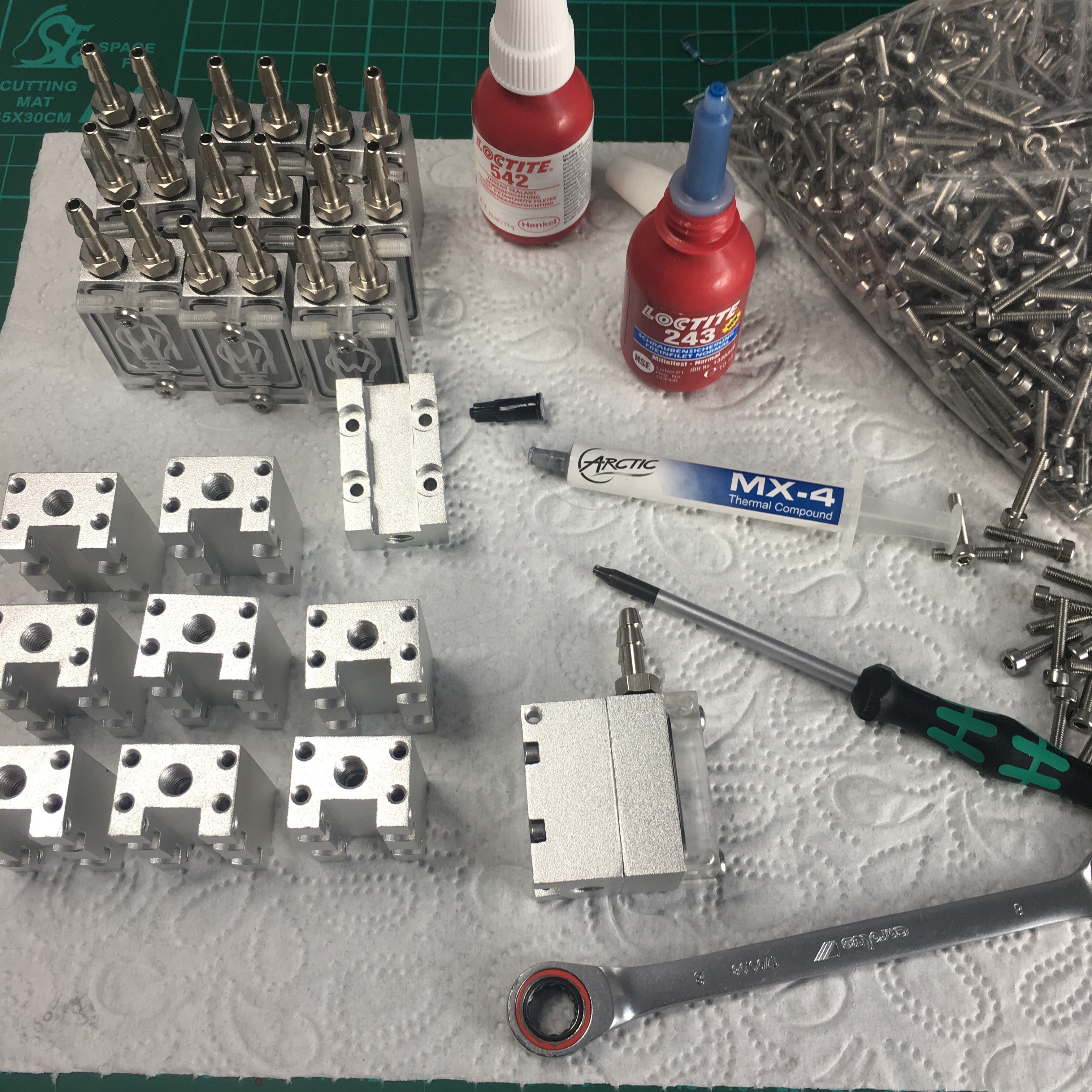

@raykholo I found reliable trust in fluid threadsealing Loctite 542:

That’s a super old either very first batch or even Beta kraken! The first barbs we used were totally self-designed and machined M8 threaded parts.
We switched to 1/8thBSPT (tapered thread) fittings in later batches, and also moved from teflon tape to Loctite 542 as per @Rene_Jurack s suggestion.
We’ve never had a single reported instance of leaking, and if that old-gen version continues to give you trouble just get in touch and I’ll get you over a new block and barbs.
