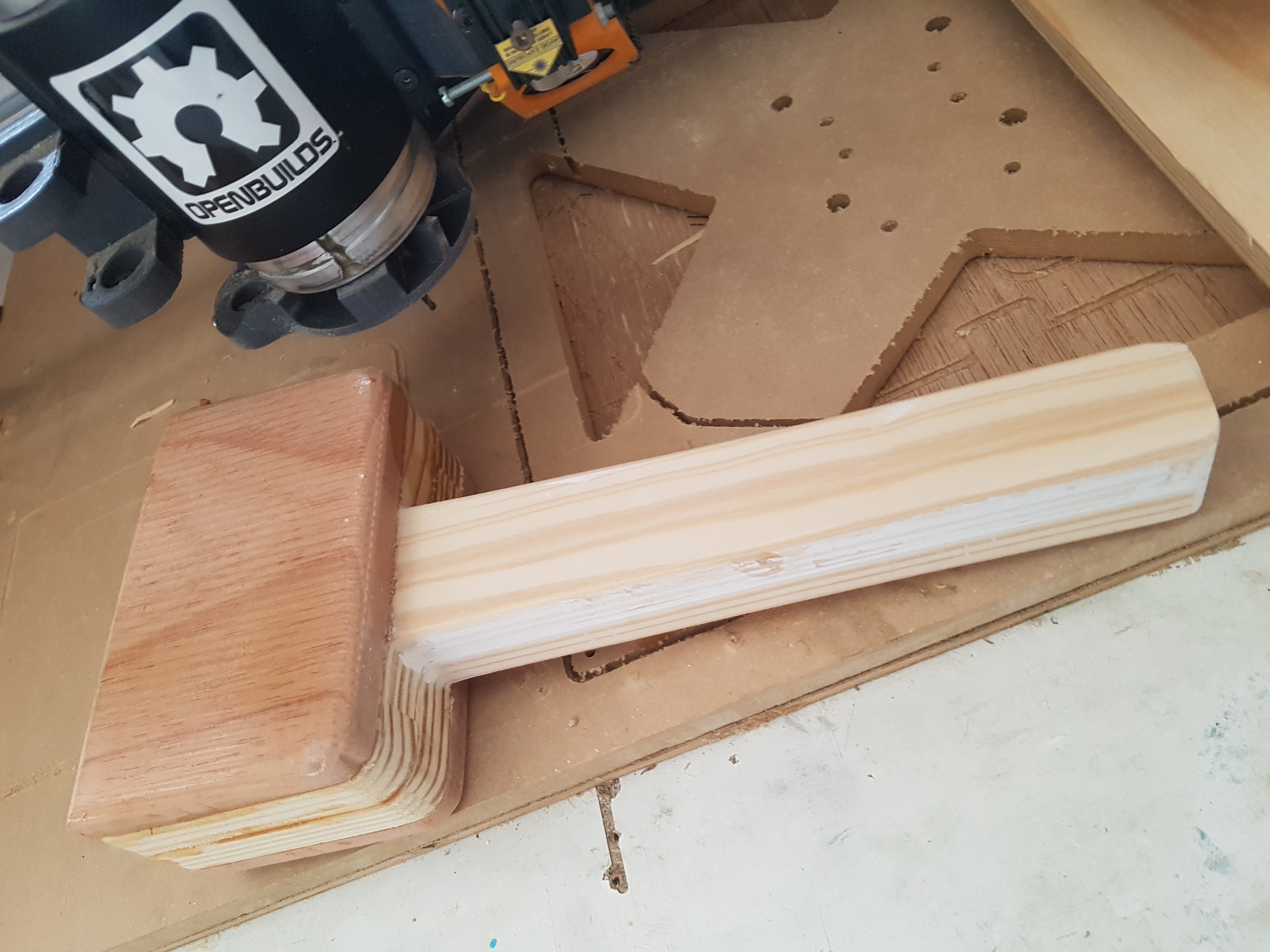

Learned how to make tons of mistakes with this one. Fusion gave me so much headache on the curved profiles.
Sanding and finish are next.
Ok and I forgot to cut the hole inside to the added weight

What issues did you run into? Is it a problem with post processing?
@Todd_Fleming โ yes and no. At some point it just did not product any gcode from the generic GrBL post. I spend some time looking for a solution , at the end I had to create the file again for it to product something. Then the Parralel operation i chose for doing the bevel did not produce the expected result. Not sure what I had wrong since I made the changes based of the example they provide.
