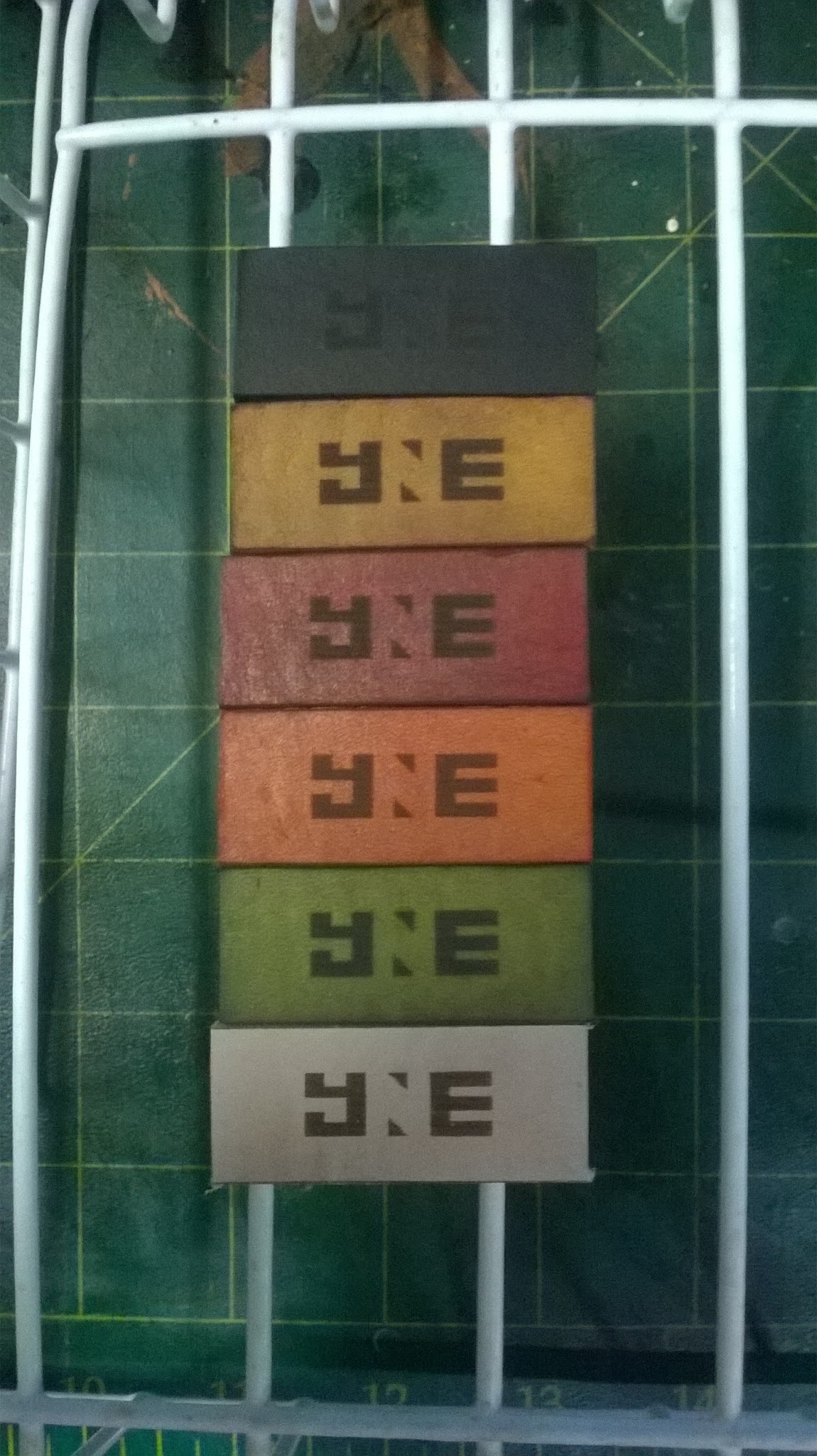

Leather pieces (laser engraved) to test out a few things. Wanted to test airpump for air assist. Works well & prevents burning. Also wanted to test new dye colours I purchased. Also wanted to test airbrushing the dye onto the leather.
Engrave @ 500mm/s @ 4mA @ 1 pixel step.
Originally shared by Yuusuf Sallahuddin (Y.S. Creations)
Tested out airbrushing on my some pieces of leather today with different colours of dye. Then I decided to lacquer them & turn them into swatches.
From Top to Bottom: Black, Tan, Red, Orange, Lime, Natural (no dye).
