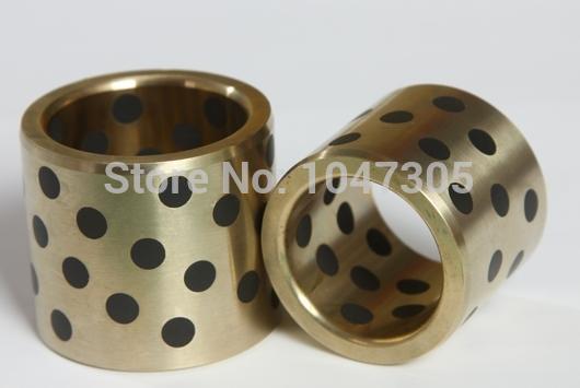

At the moment I’m planning my build. Would it be possible to push those linear bearings out and push some sintered bushing in?

with something like these:
It is just lm10uu bearings inside which are hold back by a snap ring. you can remove them by hand.
could one of these bushings work?

my plan is to use 2 bushings in each block.
Those printed bushings look also interesting. I think you would need some bushings with an outer diameter of 19mm to fit them in the sc10uu.

for the other bushings i would print a spacer/ adapter to make them fit the 19x29mm
Then this should work all right. So why not? Would be great if you could test this
i cant see any bushings in the Eustathios BOM. does any one know which one is used?
I think you could use those I posted earlier. They are also 30mm long.
