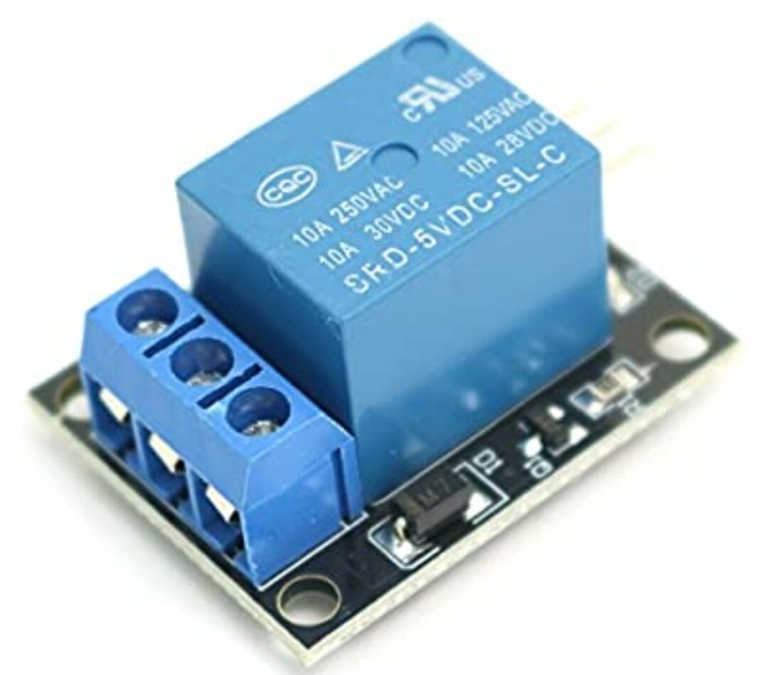

So i got an “Arduino Relay Module” :
Wired the signal and V+ to the USB positive, and V- to negative. The relay then switched when the TV was powered.
I then got a powered USB hub, and ran the PSU through the relay. I was then able to connect as many USB LED strips into the hub as i had sockets.
Works well, and is quiet an elegant solution i thought.
