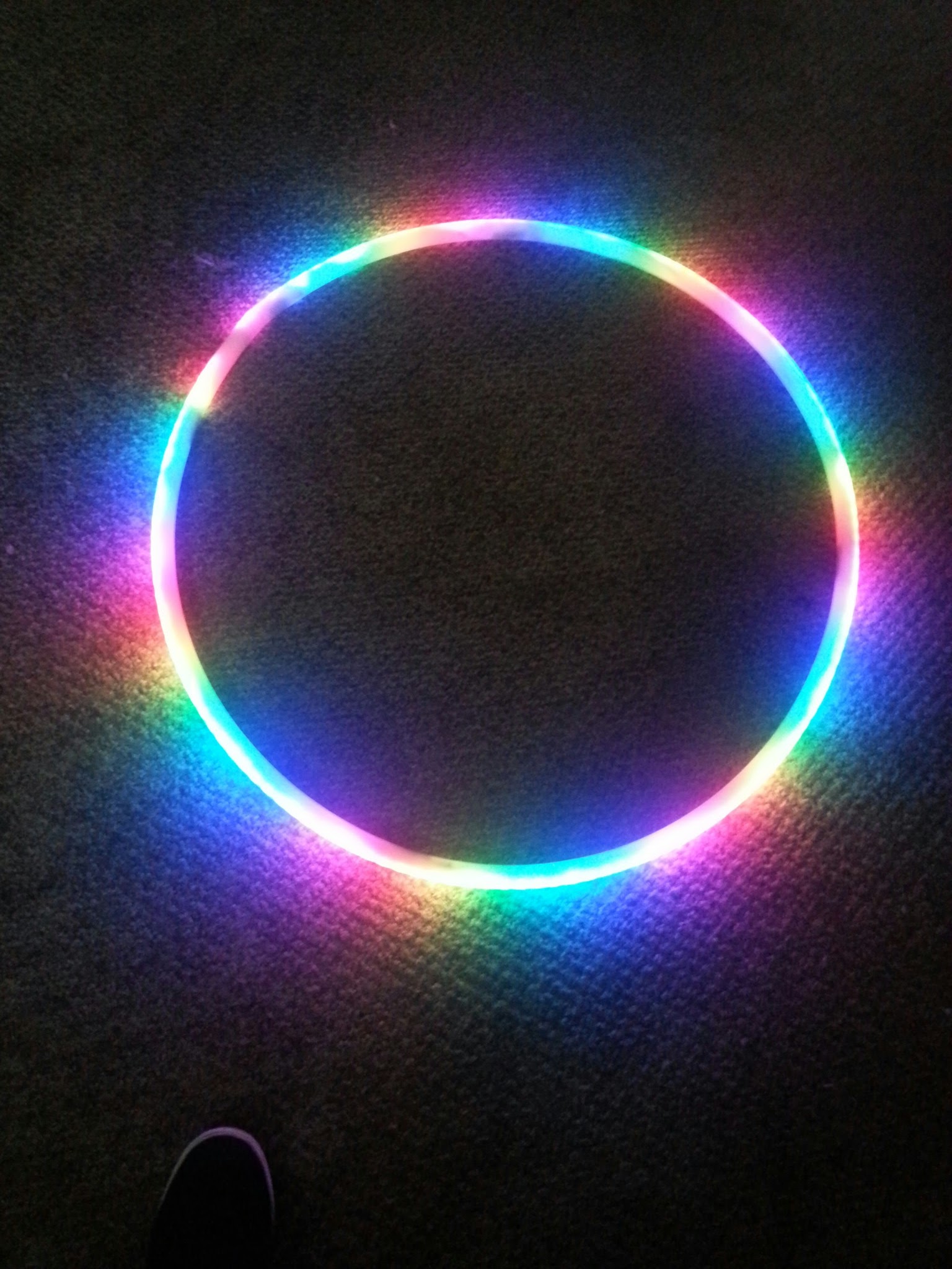

Led hoop using fastspi
That’s fantastic! Thank you for sharing :slight_smile: Out of curiosity - what are the details on it? (what leds, what controller, what extra bits? Anything nifty you learned while doing it? Any feed back on the library itself? :slight_smile:
As of right now I’m just using sample code I’m really trying to learn fast SPI but I’m not very good at to be completely honest with you. I’m really more of a hardware type guy coding is never really been my strong point.
Adriuno mini
Lpd8860
4 3.7v batteries
The hardest part so far was trying to get everything to fit in the tube.
I’m not completely clueless when it comes to coding I can edit and manipulate someone else’s code really well but to make my own is really hard.
I’ve been building LED infused walking sticks/spinning staffs for years - and yeah, getting everything to fit in has been a bear The inside of the tube is about 3/4" diameter, has 300 leds, an NRF radio, an accelerometer, and a 4Ah, 6V NiMH battery. The last stick i built before that one had a ~10" strip on one edge with no leds where the battery was, everyone thought the damned thing was a sword laugh - the current one is a bit better off. There’s only about 3" of un-lit space on either end of the staff (but my center of gravity is about 2in off, out of roughly 4’ long) - but it now has 300 leds in it vs. the 40 the previous one had. Still working on diffusion and now that i’ve got the hardware a bit further along, next up will be programming.
