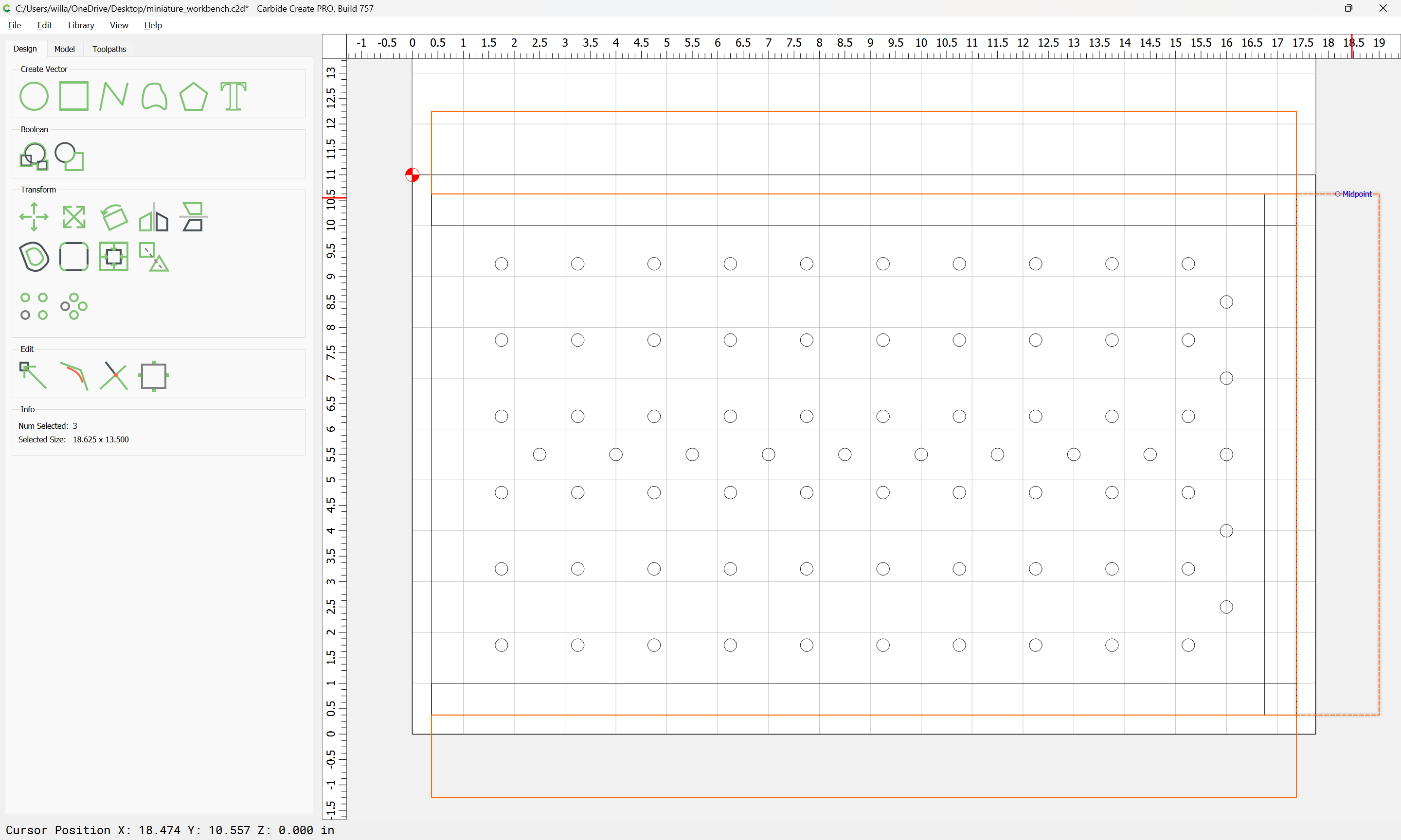

First step is making a working surface which uses the vise — using:
APTITLIG Cutting board, bamboo, 17 ¾x11" Easy-care, easy going bamboo – a natural material that adds color and warmth to your kitchen and at the same time provides a durable surface that’s a pleasure to chop and slice on.
We measure it and draw it up:
Then, since sqeezing all the parts into a single board doesn’t work, we double the height:
and start laying out parts.
This will allow us to cut in two halves, by mirroring things so as to use the same origin if need be.

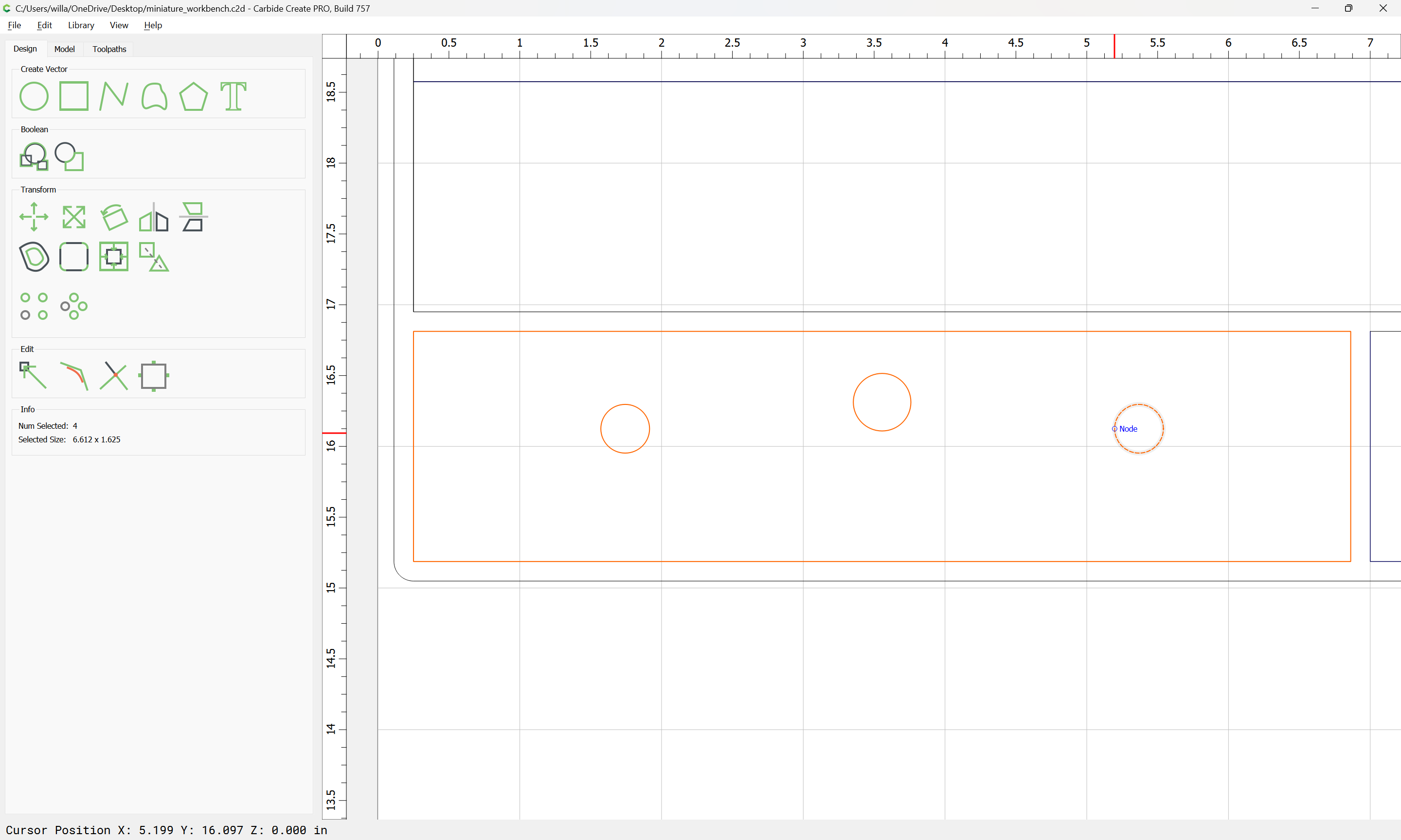

The instructions for the vise include hole patterns and dimensions for mounting the vise and making a wooden front jaw:

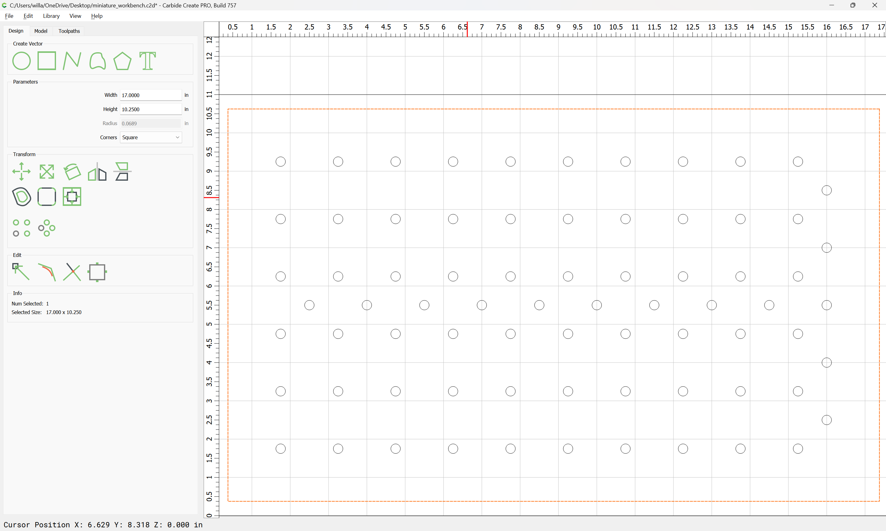

Draw in the outline of the work-surface, and add a suitable hole pattern:
WillAdams
(William Adams)

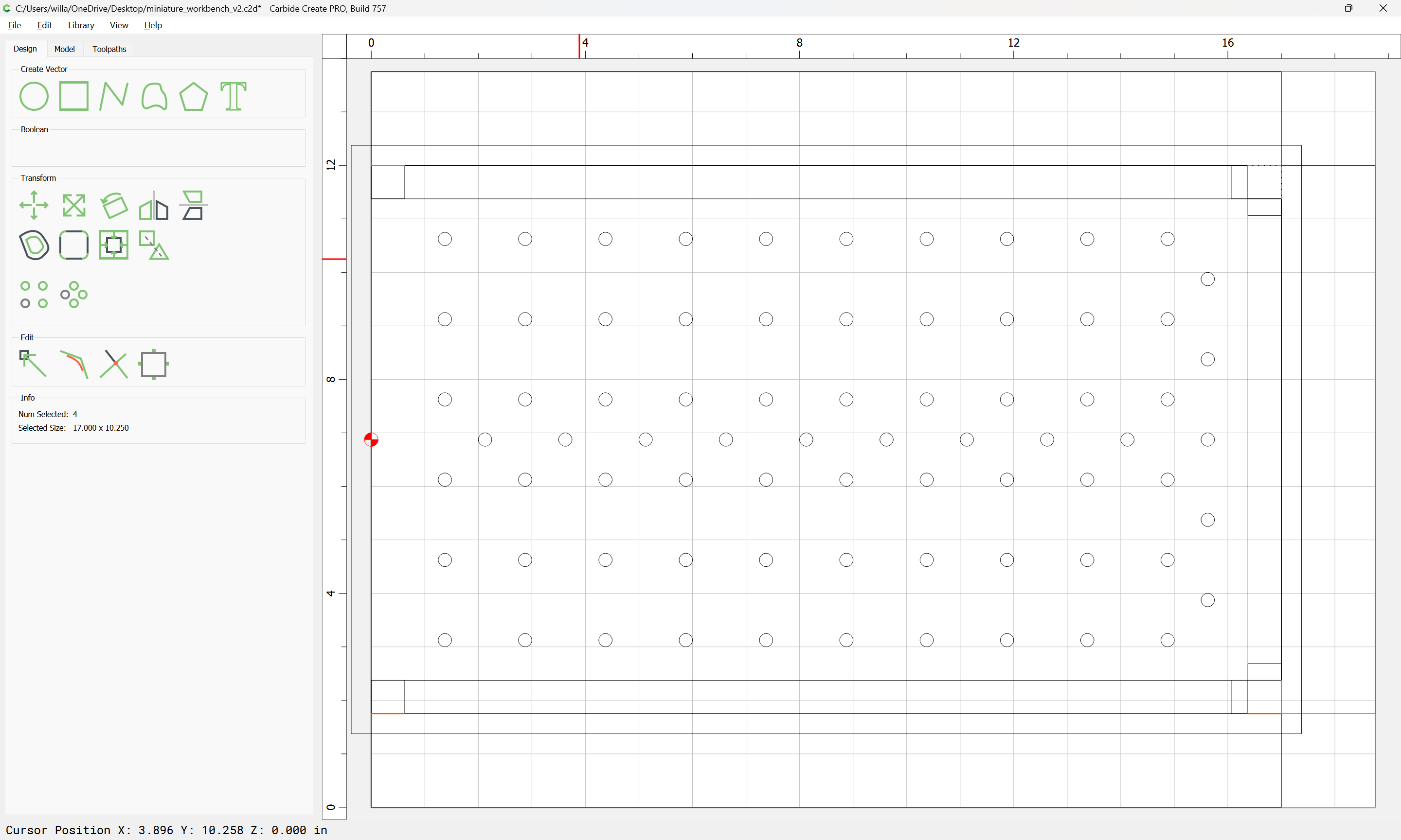

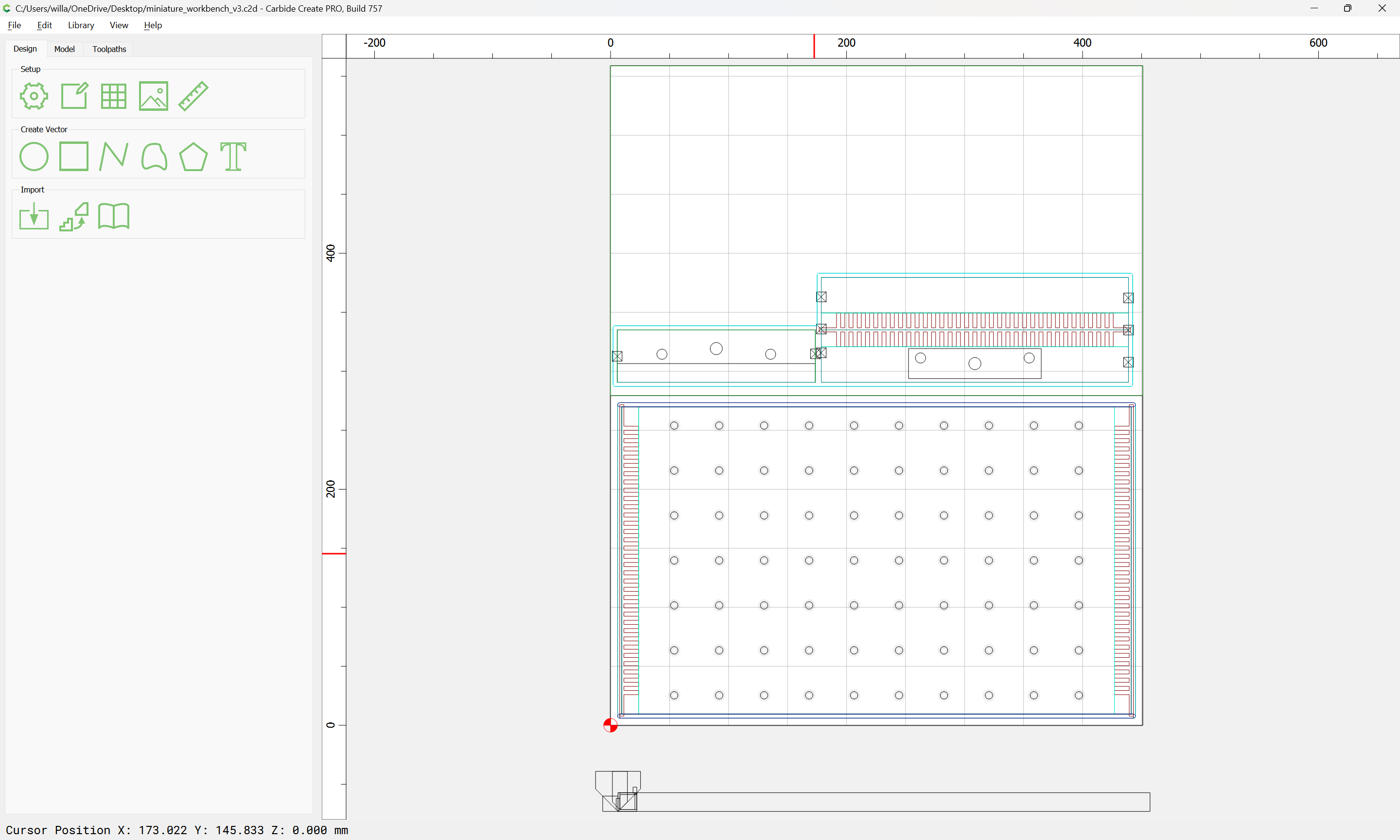

Draw in the sides both from overhead and as side views:
then set the stock to this size (we will revert to the original size once all tool paths are set up)
and begin drawing in the joinery and assigning toolpaths.

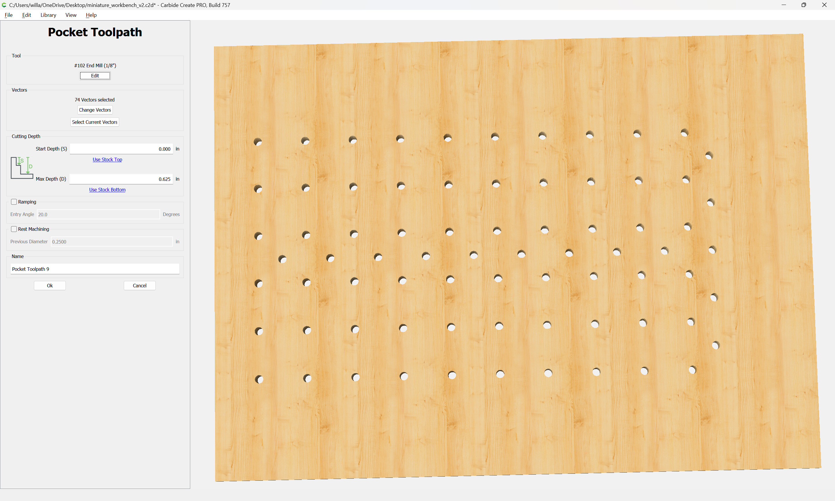

The holes are easy and obvious:
Then we begin drawing in geometry for the joinery:

Two different V tools are used, a small as noted above which leaves material uncut for the joints, and a large tool at the ends of the joints:

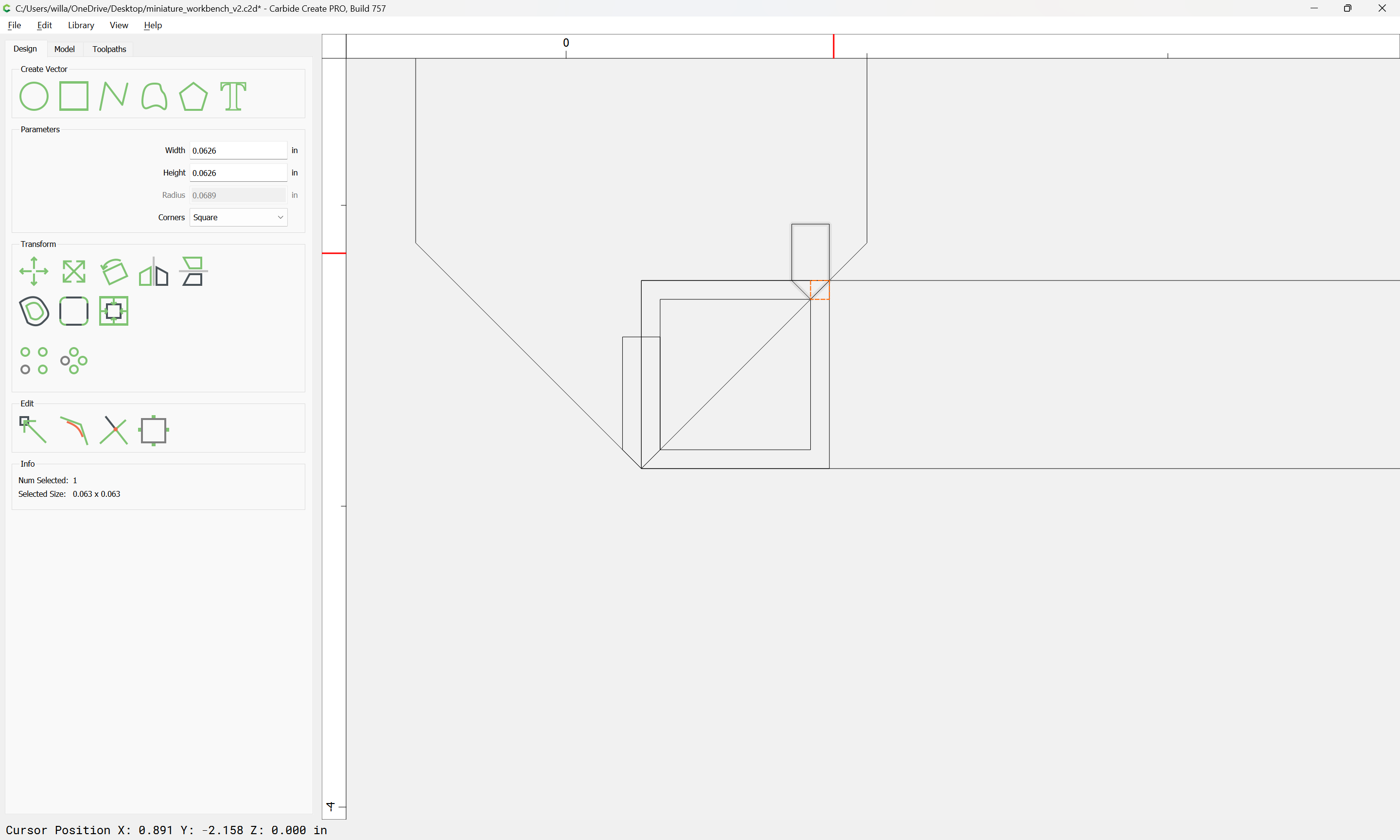

Draw the joint up in profile:
and we can see where we would need to set up the geometry to inset to clear for the joinery:

After working through this, decided simpler was better and that it was only necessary to support things at the end, so instead we have:
which previews as:
and which hopefully cut well.

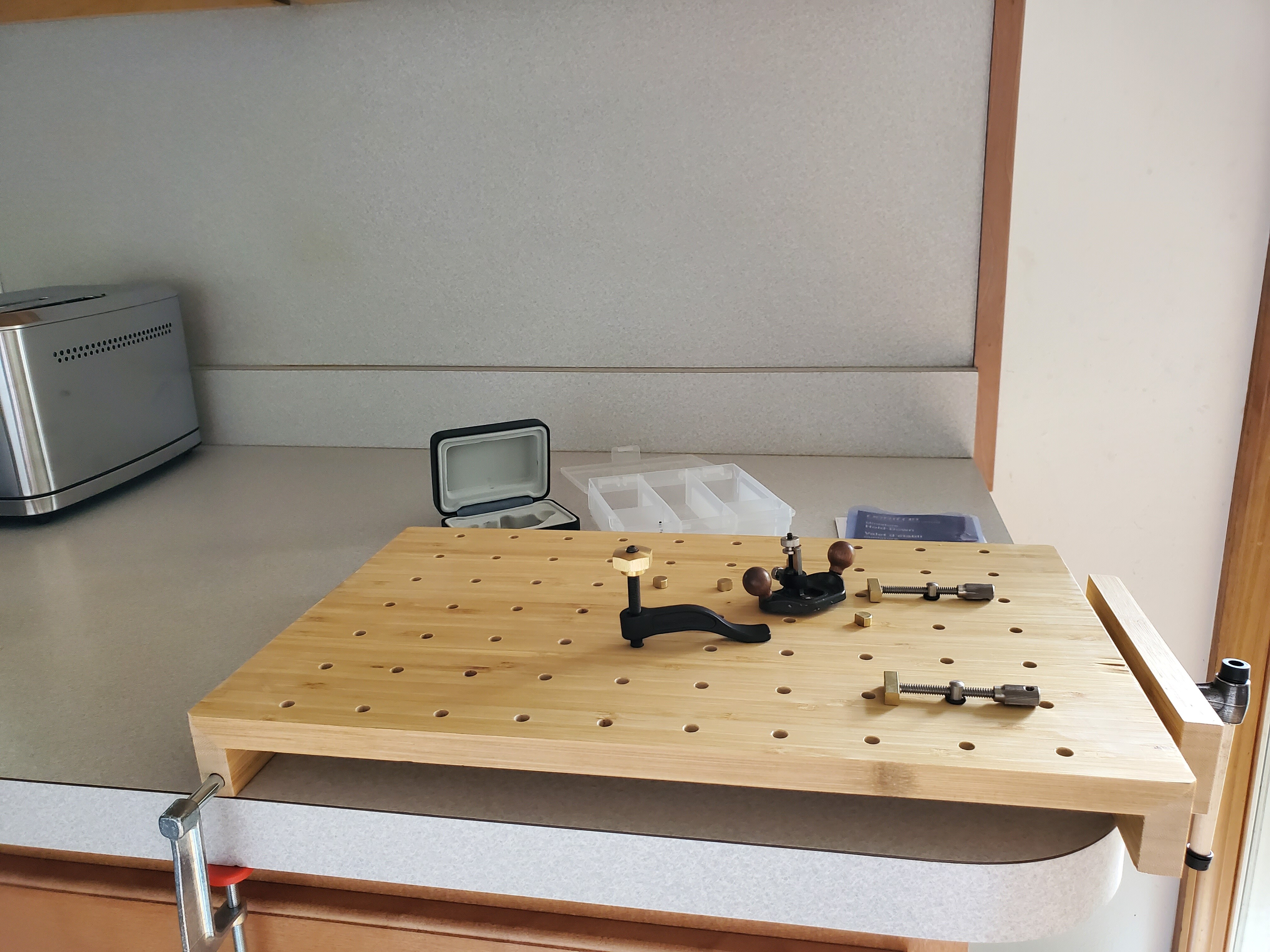

Should have cut the joinery recesses more deeply, but got a workable result:
