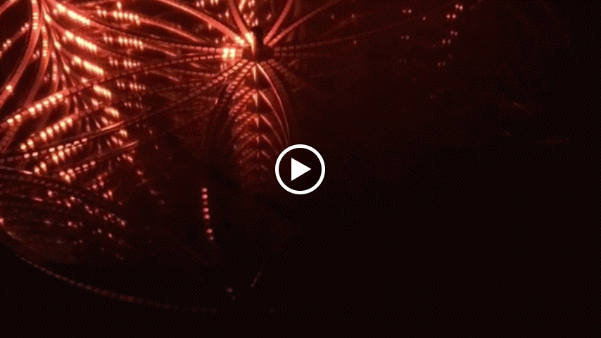

Lemur->osc->teency3.1->dmx->teency3.1/fastleds/octows2811/effect code->magic :D
Lemur->osc->teency3.1->dmx->teency3.1/fastleds/octows2811/effect code->magic :smiley:
My jaw broke, after hitting the floor. BRAVO!
Sweet lordy!
Beautiful man. Great twist on the infinity mirror concept.
Infinity awesomeness! Beautiful.
I’m flashed! Awesome mirror! Perfect done!
@Brian_Pinkham what OSC and DMX source code library did you use for Teensy3.1?
THIS is how LEDs were meant to be animated!
Every time I see another rainbow cycle I die a little inside.
Rainbows forever!!!
I use oscbundle.h (OSC/OSCBundle.h at master · CNMAT/OSC · GitHub)
and the DMX input documented here
(Arduinoesque overriding of core functionality | Teensy Forum)
thx!
Wow! The OSC library is awesome - all in one :wink:
Btw. are you using the MAX485 for DMX TTL between the Teensy boards?
I really love how you make this work - colors, everywhere colors :smiley:
Yup, max485, and thank you :slight_smile:

Awesome creation !!!
That is simply gorgeous. Very nice job.
This is amazing… Is your stuff open source? I’m really curious as to how the animations are done
Those animations are stunning. Nicely done!
This looks amazing. I’d love to see the code for this, if you’re happy to share it
I’m not in the habit of sharing my effect code, is kinda my secret sauce and what I make my living of of :wink:
That was truly amazing. Perfect combo of wow with subtle styling.
@Brian_Pinkham first off, I have been following your work for a little while now and it is really wonderful in many ways. It’s always rad when someone follows there passion and it is very obvious you are doing that. My question for you is in how you fabricated this piece, which is very well done. Specifically the LEDs. Are you using strips, modified strips, custom PCB? The slight curve has me thinking they are PCB. Thanks!
Thank you :slight_smile: and yessss completely custom curved PCBs for this piece
