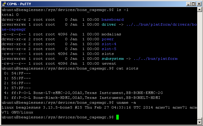

So, what works and what doesn’t? For starters, the cape manager and device tree overlays work. Capes are detected and the proper .dtbo is loaded. Nodes are added into the device tree and drivers are started as expected. Beyond that, things are still a bit sticky. Changes in the main device tree binary blob require some changes, particularly because the 3.13 .dtb for the BBB has several features hard-coded in. These step on the dynamic loading of the same features via the cape manager.

For the HDMI cape, I can see the TILCDC driver and NXP TDA drivers starting in the dmesg log. But, this still needs some work because the i2c bus is reporting errors (most likely due to the HDMI audio support). An “fbset” will report that the video mode has been set, and /dev/fb0 exists, so most of the plumbing is hooked up and initializing.
