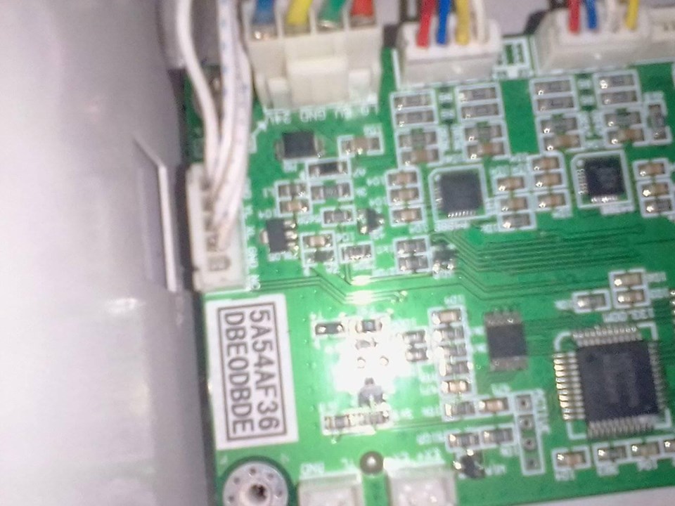

Can you provide a picture of your controller board?
its the nano2
sorry not the best quality…
@pixelsaint If the driver is installed properly and K40 Whisperer still does not work I don’t have a good solution for you.
