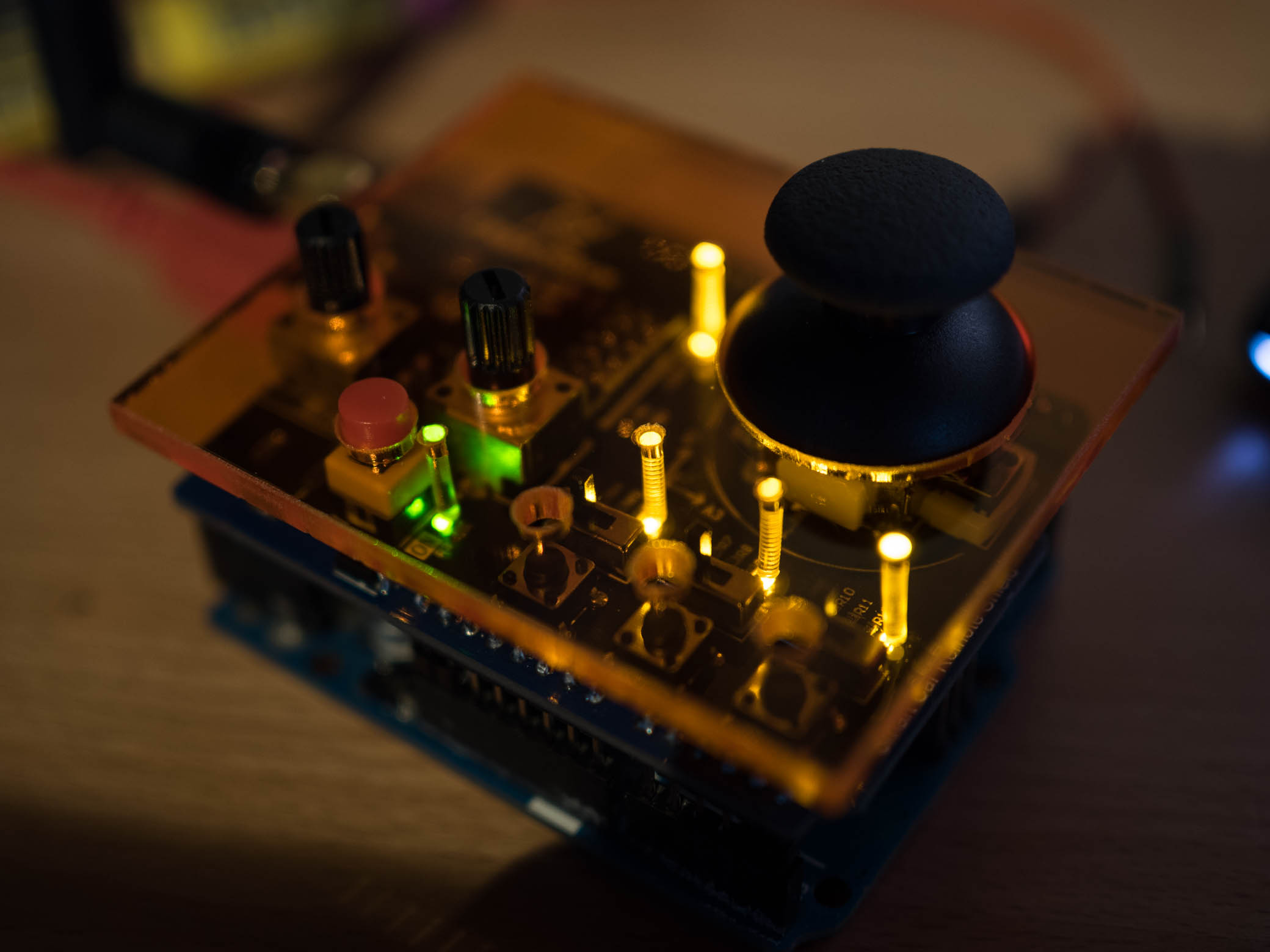

Light channels test with transparent filament,
Light channels test with transparent filament, looking great !
which filament?
Clear petg, I don’t remember the brand. But not revelant I guess as long as it’s clear
nice! … if you add a phototransistor you can use this as an optical bend sensor (tested this for a VR-glove)
Gets a bit more challenging if you try to bend them. As long as the clear filament is not bent to far (so before the plastic at the bend turns white) they actually work over a good distance too. Just hard not to bend them to far though.
