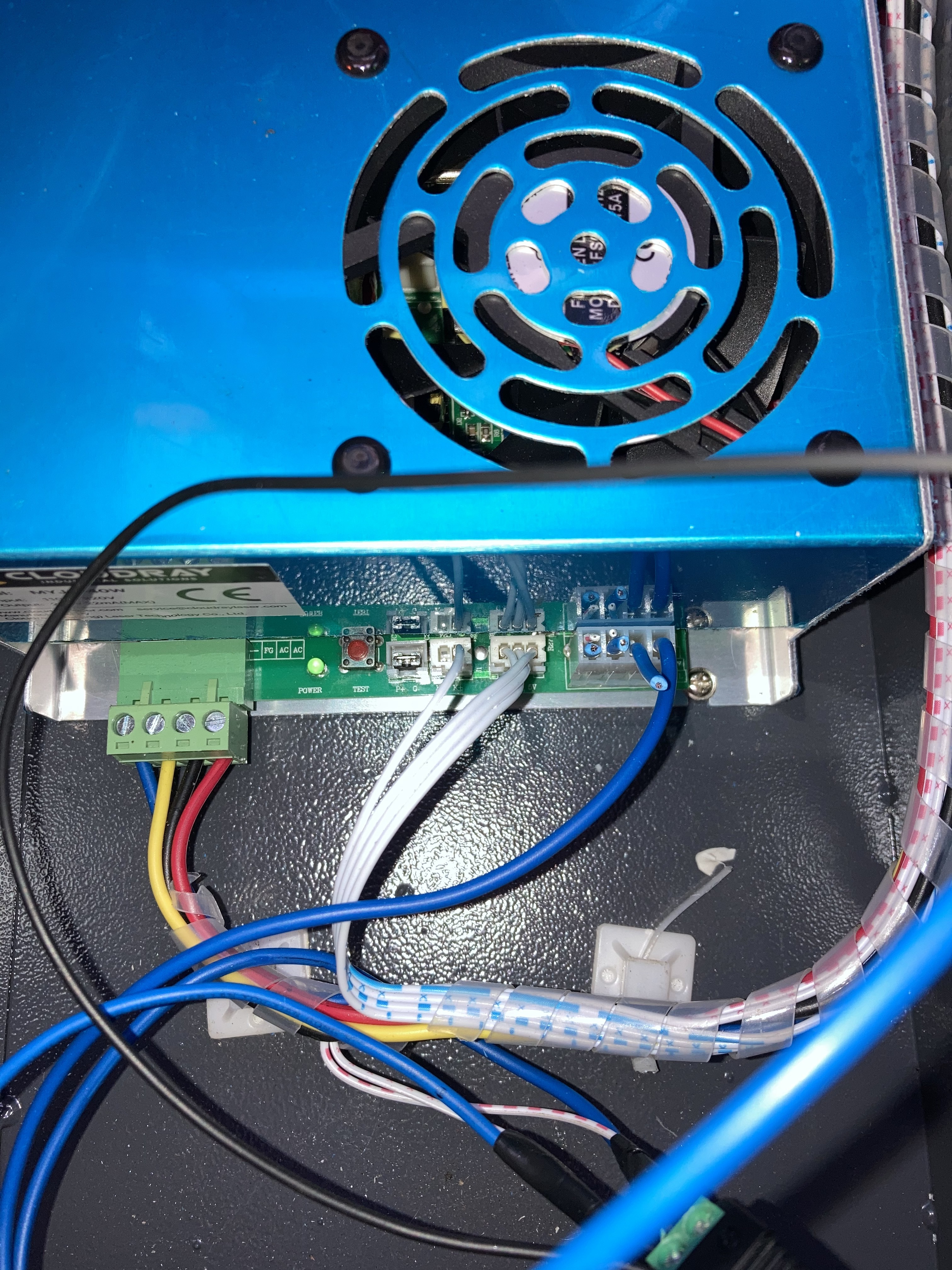

As I’m waiting for my pictures to load, I’ll say a few things. I don’t have any door safeties, waterflow safeties or any other safety features, I will install those after I get the laser working. My 24V power supply, is a 6amp computer supply from Amazon, I confirmed that that has 24V and the bed turns on and homes when I plug the 24V supply into the wall. Also my 5V supply is an arduino with the 5V wire going into the 5V pin and the ground pin going to the 24V power supply ground and also to the ground on the m2 controller. I am a it concerned that my arduino might not be giving the current that’s needed by the controller, do you know how many milliamps it should be?
The 24 V power supply is wired to my LED strip (which came with the laser), the 24V on the control board and the ground on the control board
Neither the laser test button on the psu or the top of the laser cutter fire the laser.
I do still hear a sizzling sound at the back of the laser when I fire, near the laser tube (I am too scared to open the laser tube cover when I fire, I like my 20/20 eyesight). This makes me think that the laser tube is getting power, but that power is shorting someplace, I just can’t find a wire that would be shorting out on the tube
I am wondering why you didn’t leave the wiring between the controller and the LPS alone since you bought a compatible LPS?
Did you just make these wiring changes?
You’re using the Arduino as a 5V power supply to power the controller? Why?
Why not reconnect the new LPS 5V to the controller. Same for 24V?
The LPS provides 5V@1A to the controller so you need at least that much for it to work reliably.
It looks like there is no ground on the LPS input (right connector). Only the L is connected.
The ground of all the power sources: 24VDC, 5VDC, the LPS, and the controller need to be tied together.
I think that pin on the Arduino Uno only provides 500ma so I would guess you are running the controller marginally. However, that should have nothing to do with the laser not firing with the test switch down on the LPS. The 5V has more to do with the operation of the gantry and the laser’s imaging. The L pin on the LPS from the controller turns the laser on and off when running a job.
The test button down on the laser should fire the laser irrespective of anything else. That switch overrides the control panel and the controller’s inputs.
Where does the blue wire on the far left of the LPS go to?
