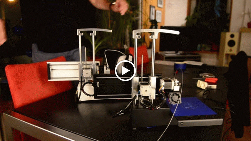

Listen to the white Printrbot  simple metal:
Listen to the white @Printrbot simple metal: When the Y-axis gets moved there is a clicking noise. I guess the linear bearings are damaged. Any other ideas?
Besides that, the couple prints like a charm. :slight_smile: Tomorrow I will post some pictures and a short report.

Definitely sounds like some kind of bearing, either the linear ones or the radial bearings in the stepper.

@enhydra if it’s one of the linear bearings, a bit of lubrication (not WD40, but a heavy lithium grease) might already fix it for you. To really get the grease in there, i’d recommend removing the smooth rods and pushing the grease into the bearing.

X bearings are easy to replace, but y bearings are more involved, requiring a press and a precisely sized pusher-outer (technical term). Fill out a ticket to report bad bearings on a new assembled bot within the warrantee period. I will defer to our excellent support folks.

I had the same problem. I was out of warranty and wasn’t going to buy a whole aluminum block. The bearings knock out pretty easy. After the replacement and putting it back together it was doing the same thing.
I then noticed loosening the screws holding the aluminum blocks helped. So I started flipping blocks and rods and finally got them sliding smooth. So it might be and alignment issue not bearings.
Good word!
@David_Worth1 Hej, you made my day! I just removed the “cover”, loosened the screws you mentioned and then reassembled everything. That’s it. :slight_smile: Thanks
