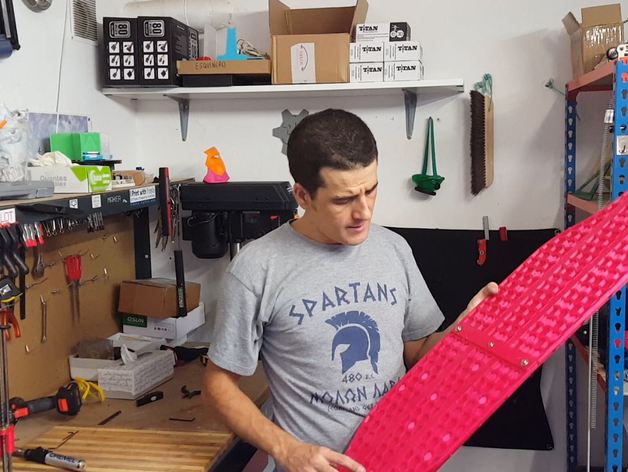

Longboard printed in Pegt, seems to work!!!
Nozzle: Volcano 0.6 mm, Layers 0.30 mm infill 40% - total weight 1.7 kgr in 64 hours of printing.
It is a good means of transport
What machine?
He desing his own machine XL3D
Wait will this be electric??? I’ve been dying to build one that is electric powered!!
Look for indalo3d in youtube @Griffin_Paquette ​ he has a building video
This is crazy awesome.
@Griffin_Paquette , yes it’s an electric longboard, sorry for some spam ;), assembly and technical details https://www.youtube.com/watch?v=uWME9DEzvfg
what is the size of that printed item ?
@Shachar_Gafni total 1040 mm in two pieces of 520 mm
