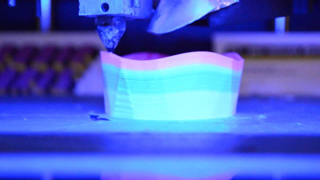

Look at here. 3D printing in 3D (e.g.
Look at here. 3D printing in 3D (e.g. no traditional slicing !!) with Z-axes going up and down !! It is using Cura, but I would like to have the same with skeinforge…
I would like to raise a question to the owners of an Ultimaker printer that can try it: “How can you prevent that the object crashes the bottom X axes of the hot-end, while lowering and trying to reach a too deep Z position ?” I suppose that not all objects are adapt to be printed in this way…
Another comment is that with this technique you are able to print a SMOOTH pyramid or any angled shape without steps !!!
There are still layers, all you’re preventing is the layer boundaries that cause little surface marks if your hotend oozes.
Well… I have a 4 axis CAM we can build on. To get even more :wink:
Tool collision I not difficult if you can model your tool out of specific primitives and are limited to models made out of triangles anyway.
This will only work for the outside surfaces and will only work at very slight angles. The best you could hope for is angled/curved surfaces that look similar to vertical surfaces do now. An articulated head would be required for any angles over a few degrees. The slicing/cam software would be much more complex to choose the proper paths and to avoid crashing.
