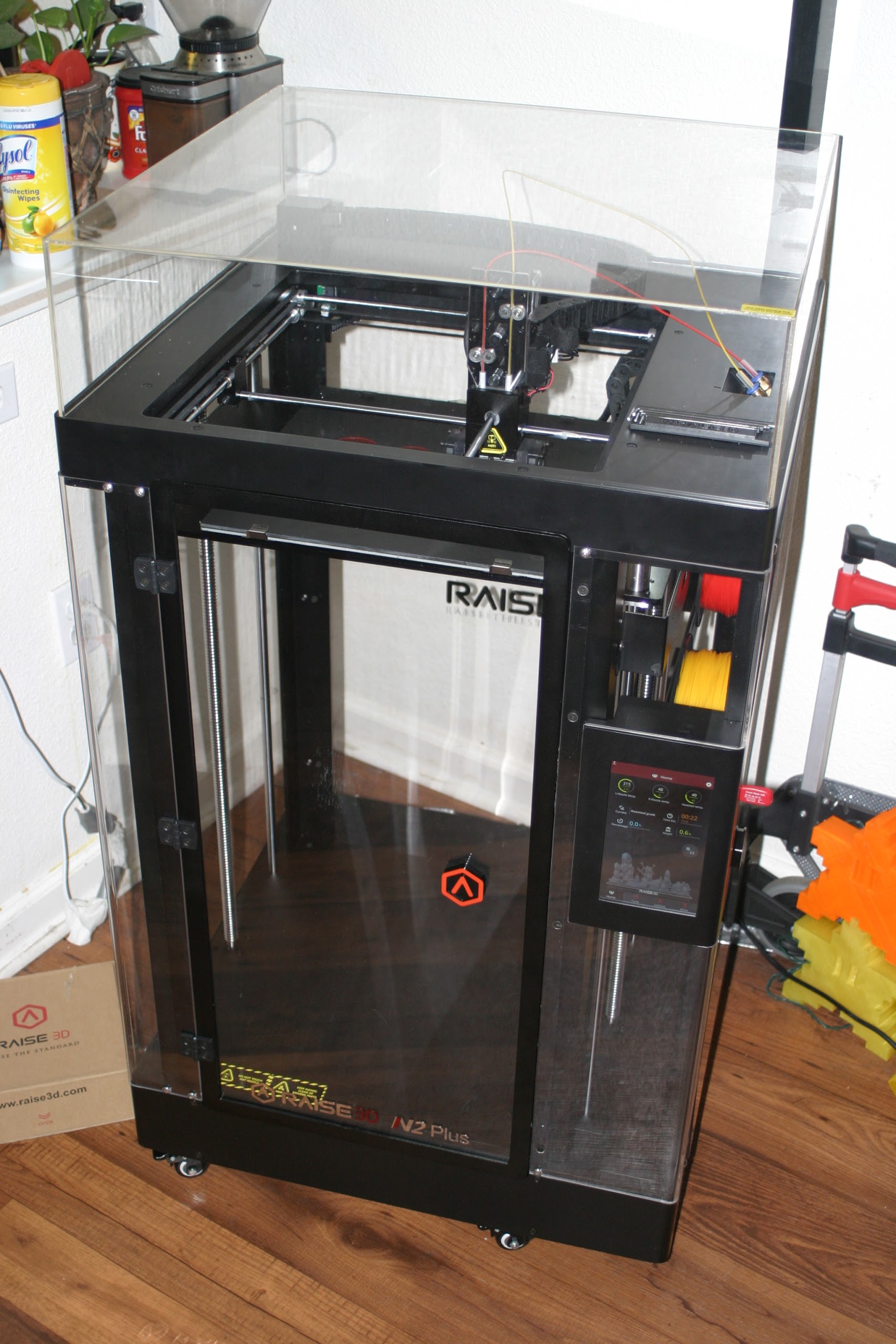

Look at what I just brought home! I backed them on Kickstarter quite a
I backed them on Kickstarter quite a while ago after seeing them at a makercon in LA when I was representing 3D Hubs. Got the biggest machine they have the N2+. https://www.raise3d.com/collections/all/products/raise3d-n2-plus-pre-order-fdm-3d-printer (Super glad I didn’t have to pay that much (: )
First of all, the packaging is friggin excellent. The shear amount of foam surrounding this thing is enough to keep it safe even if it dropped off the loading dock I think…
I had it printing it’s first part (a better filament guide) within minutes of turning it on. Bed level was perfect just had to adjust the z-height a little. I have it running a 20 hour print right now to test its detail capabilities on small parts with http://www.thingiverse.com/thing:609167.
Not too much else to say at this point as it just works. I’m using the Ideamaker slicing software that they provide for now but I will experiment with Cura, Slic3r, and Simplify3D later.
