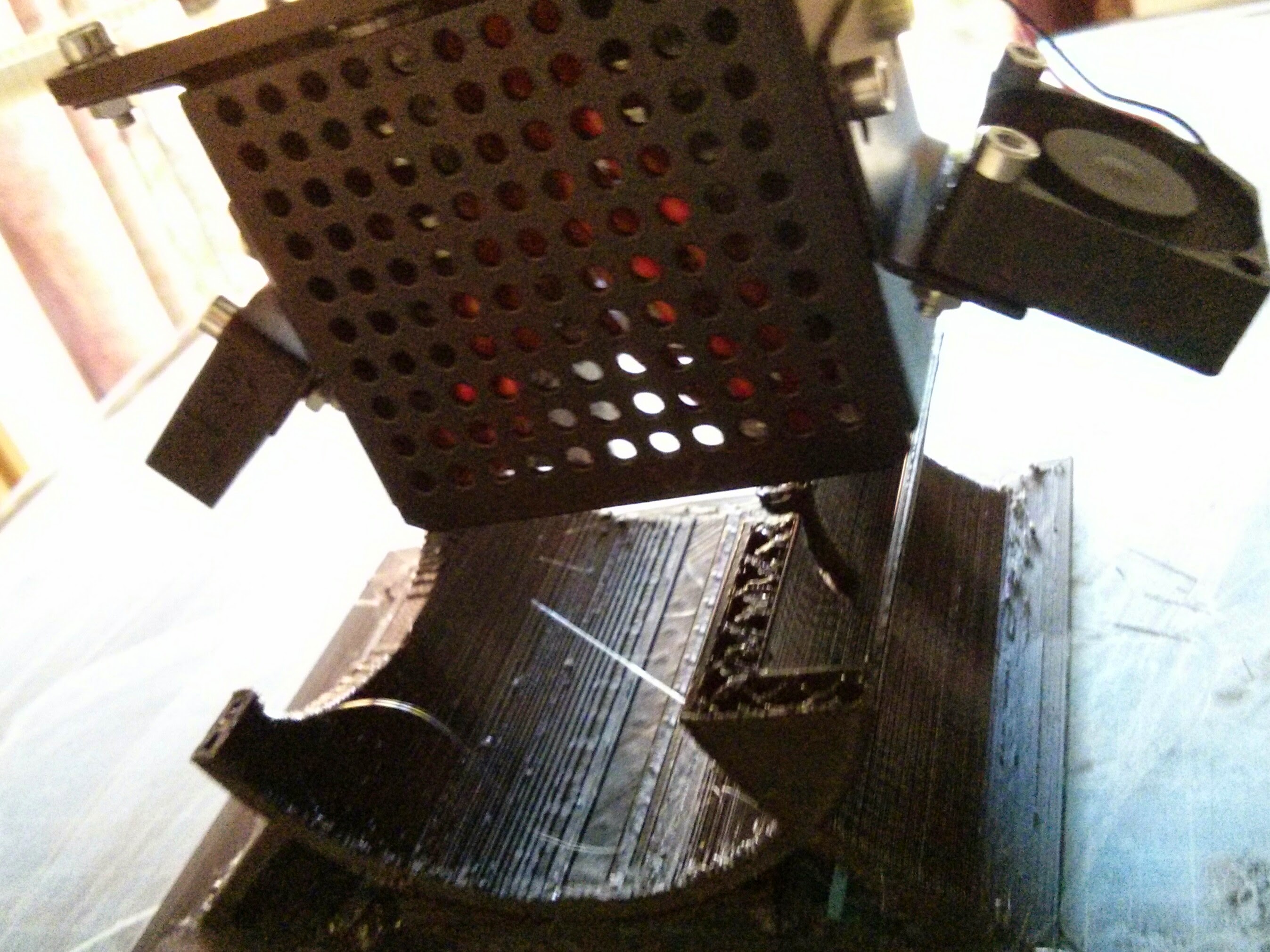

Look Ma.. no support material..
Look Ma… no support material…
…was expecting this print to fail spectacularly but somehow it managed a 4cm bridge?!
With pet 4cm don’t sag at all for me. The perfect bridging setup for me so far is
Very sharp tipped nozzle
PET
Precise material amount
No heatchamber
Medium speed
