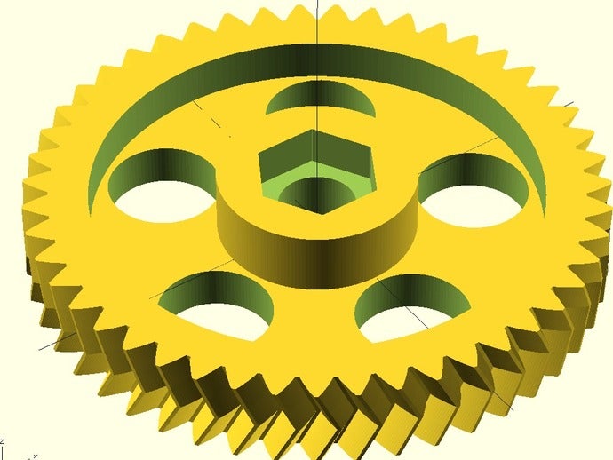

On the talk of geared extruder setups I need serious help…here is the deal…long story short I CANNOT change the steps per min feedrate so please don’t ask or recommend that…I have a Wade Bowen extruder and my Feed when sending 50mm comes out to 151mm. HOW can I figure the size to Reprint the Gear to have this offset handled by the gears and not software? If someone could make it that would be insane awesome…please help. And once again I can’t change in the software (M3D)
This seems to be the right gears for my setup…just don’t know how to remake to reduce the 150mm to 50mm…
